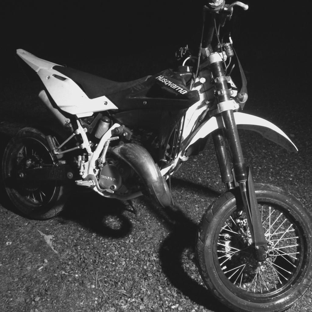

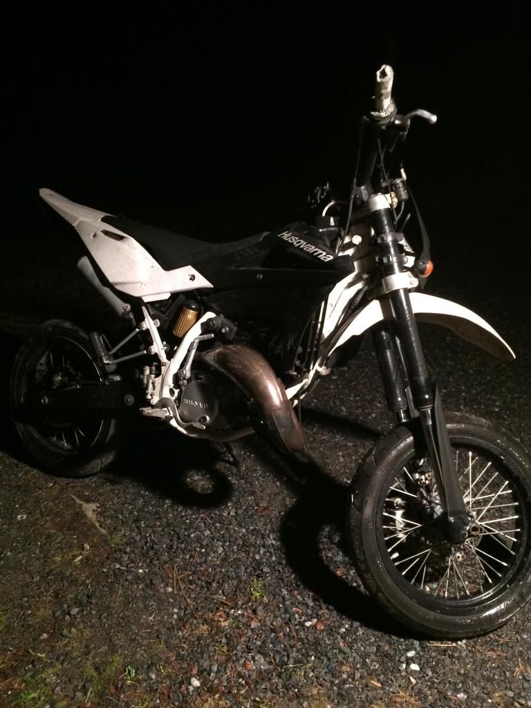

When we got to my uncles house we took the husq to the garage and decided to investigate it the next day. When we had the time for the bike we discovered it was far from stock. It has lots of power and it was really different than my friend husky. We realized that there was no battery, the speedometer doesn´t work,Powervalve system doesnt work because it´s wr topend in sm 2008 bottom end, there were no blinkers, fog lights didn´t work neither did horn and it time to work it.
So for now the "powerparts" are
- 144cc wr top end
- 34mm mikuni
- wr inlet manifold
its not much but im planning to buy v force 3 this winter and maybe lower the cylinder head.
And for the looks, picture tells more than a 100 words
Shitty quality :(
I will tell more and take better pictures when i see the bike next time but for now any opinion and suggestion are more than welcome.
