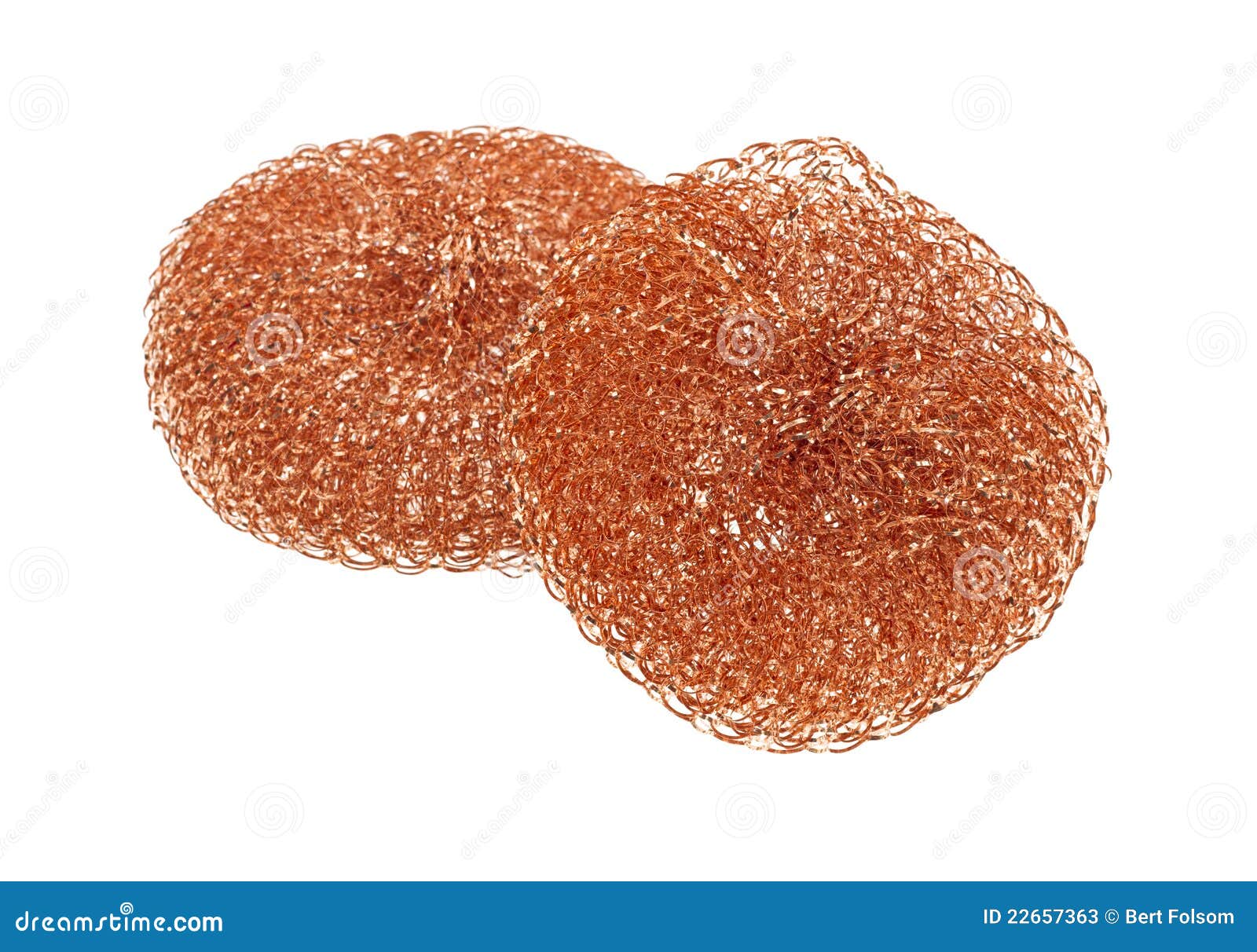

I use scouring pads made of thick copper wire, and just loop the doughnuts around the core....

chore boy?

the copper stuff doesnt burn...its thick and actually its copper coated stainless but it does not burn or melt....i have tried :)
