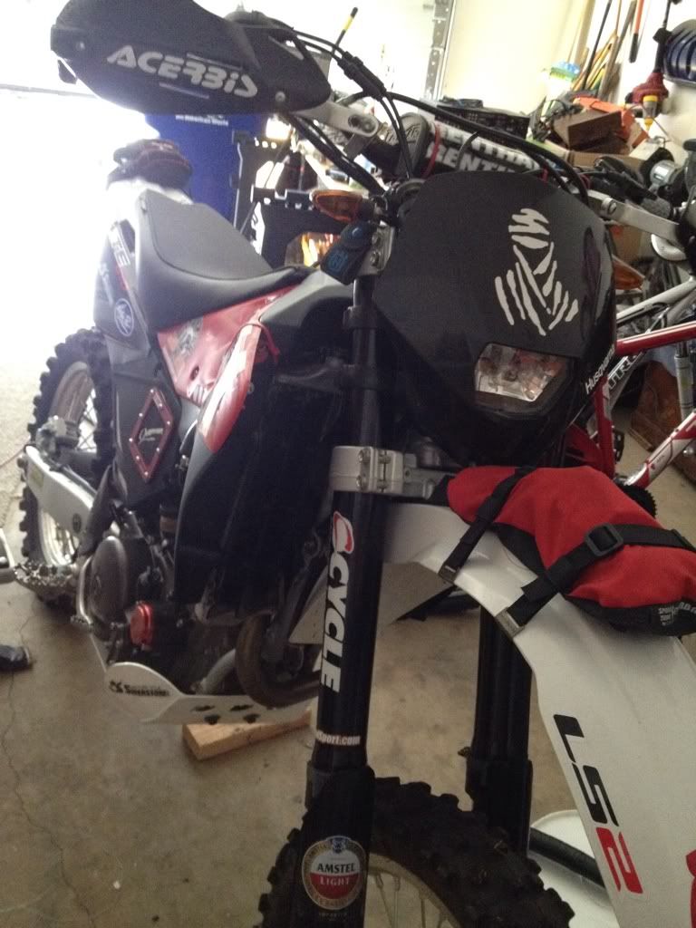

Strip every unneeded part of and some of the needed ones also and she's still heavy, but I manage pretty well and would do it again of I could
here she is after about 30-35lbs of dieting (passenger pegs off+-8lbs, stock can off+-10lbs, rear taillight and assembly off+-5lbs, stock battery +-8 lbs, and a few other odds and ends gone. All set to do the Berlshire Triple 100 miles of some very hard riding.
You can shed 28 pounds off immediately with a Leo Vince exhaust and a Ballistic (or Shorai, MOTY Designs, et al) battery. Then there's a bunch of other stuff if you're looking to shed ounces at a time.
