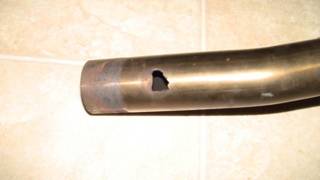

Ok , dont laugh, Has anyone had a hole burn thru the mid pipe ?
I have a SM610 with app 2500 mile ( new , leftover )
I heard a pop while down shifting and then hissing noice , thought i blew a doughnut gasket of some exhaust bolts loosen up. Got home , first the heat shield end was melted and a hole a little smaller than a dime , right thru the mid pipe ?

Headers not RED HOT after a run ,
This was after a 150 mile run thru the counrty ( with a gsxr 1000 chasing me , hehehe )

Re the ACTUAL pipe, sounds more like a defect. Can't say I've heard of this (unless your headers are rusty old tubes) which is unlikely?
Ok, now waiting for my third heat shield , the new on lasted a few hundred miles , coming loose and breaking off at the tabs. WTF!
Does it run really really rich or really really lean?
Do you leave it sitting in the rain for long periods of time without cranking it?
I had the exact same thing happen to mine 2 weeks ago while riding at Deals Gap. It appears the shield bolt on the bottom at the muffler end fell out and left the upper middle bolt to carry the load. Mine broke the tab off and left a gaping hole in the pipe also. Luckily I found one from a TE on Ebay for $40. I'm going to grind off the bolt weld nuts and exhaust wrap it.
i bought exhaust wrap and ties to replace the heat shield, only to discover a hole in the bottom of my mid pipe. the local parts store might have a solution. if not, maybe an exhaust shop, as ideally, i'd like to have it patched and all of the heat shield posts removed from it. that way, i could replace all the heat shields with exhaust wrap, as the shields have done more harm than good.
I had this happen to me too. The nuts / bosses that are welded to the pipe that you bolt the shield to can crack due to vib and stress from tightening the bolts for shield. I found 2 out of the 3 on mine had cracked at the weld. I just got the mig welder and beefed up the welds. Be sure to turn the welder down when doing the one where the the pipe goes 2 to 1 as its very thin and you can burn through very easy.
