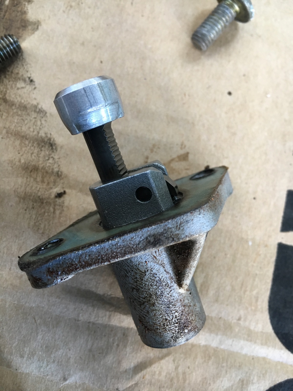

I had the local Honda motorbike dealer "clean, prep and serve" the bike this summer (all fluids, lubricate whatever needed etc). I rode it for 3-4 weeks before I had to go home to Europe and it rides very well. Before leaving for home I pulled the CCT and found it on 10 clicks. Well, time for a new chain at approx 7800 km.

* all the camchain stuff, gaskets, o-rings, liquid gasket, chain etc (+reed valve)
* perhaps the APE manual tensioner?
