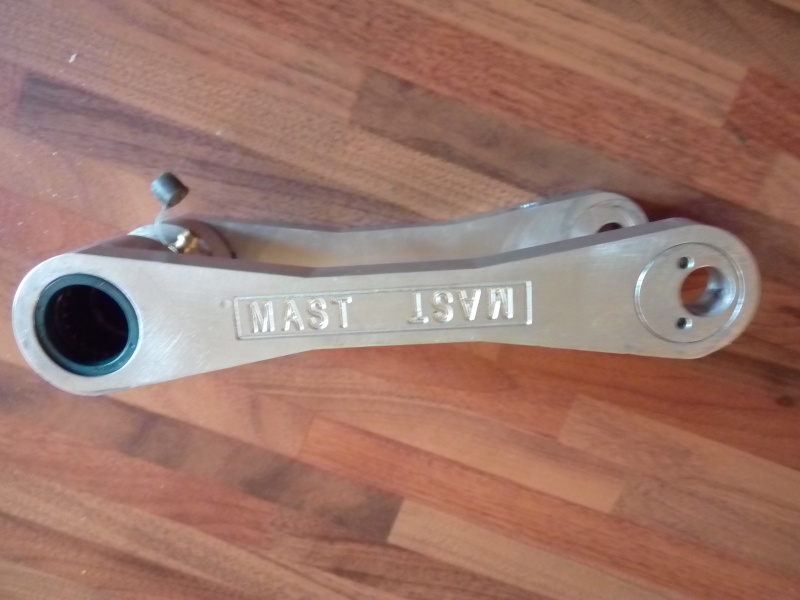

My 2010 smr is definitely too high for me, still wondering why they made these bikes like that. Anyway, kubalink is a little too much money imo but I have found an ad for the following link, half price of a kuba, seller says -2cm. Never seen one like that before. What do you think?
Yup i can vouch for those type or reversible inserts frind in SA uses them very popular there.
If its longer than your linkage then it will lower it.
I lowered mine 1.3/4" seat height with just 10mm of extra length in the linkage.
Measure your linkage and compare also 2cm isnt much.

drop some money and have the forks and shock reworked so you have a lower seat height. don’t b a cheap ass. links change the ratio and the dampening curve which you do not want. if for street use and track. the bikes do not need 13” of travel. i took 7 inches out of mine. lower CG, rails turns like it is glued to the track.

I guess you are right all the way; that bike is not really acting like one would expect from an "almost ready to race" supermoto, and I don't want it to be worse. I just did not know that could be achieved with forks and shocks reworked ( I you could explain that a bit, I am not really a techy person).Not really trying to be cheap, but I honestly thought another link was the only way to lower the bike.

If memory serves me right, some people had issues with links contacting the swingarm and causing damage.
