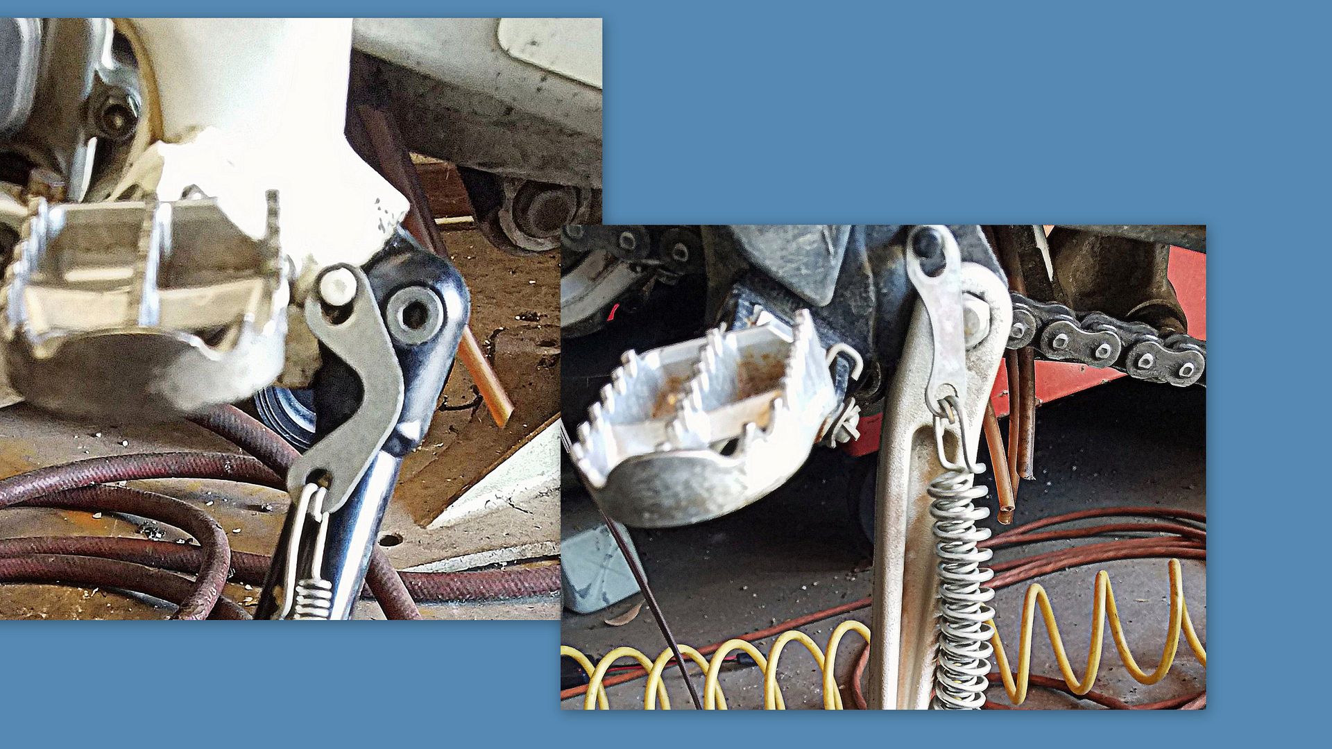

The weather here is sweltering....thus, I am not of the inclination to go out and do any kind of work in the garage. I can tell you this, though....the kickstands are approximately the same length from foot to center of bolt and the mounting tabs are the same thickness. Shape of tab and where the spring peg is on each varies.
Thank you so much Dirtdame .... your the best !!! ..if you were closer I’d be sending over some cold ones for you .... the pics are great !!!

Currently running the cast aluminum stand of my '14 310r on my' 10 wr300 it works perfectly other than the foot is angled up but it works fine
