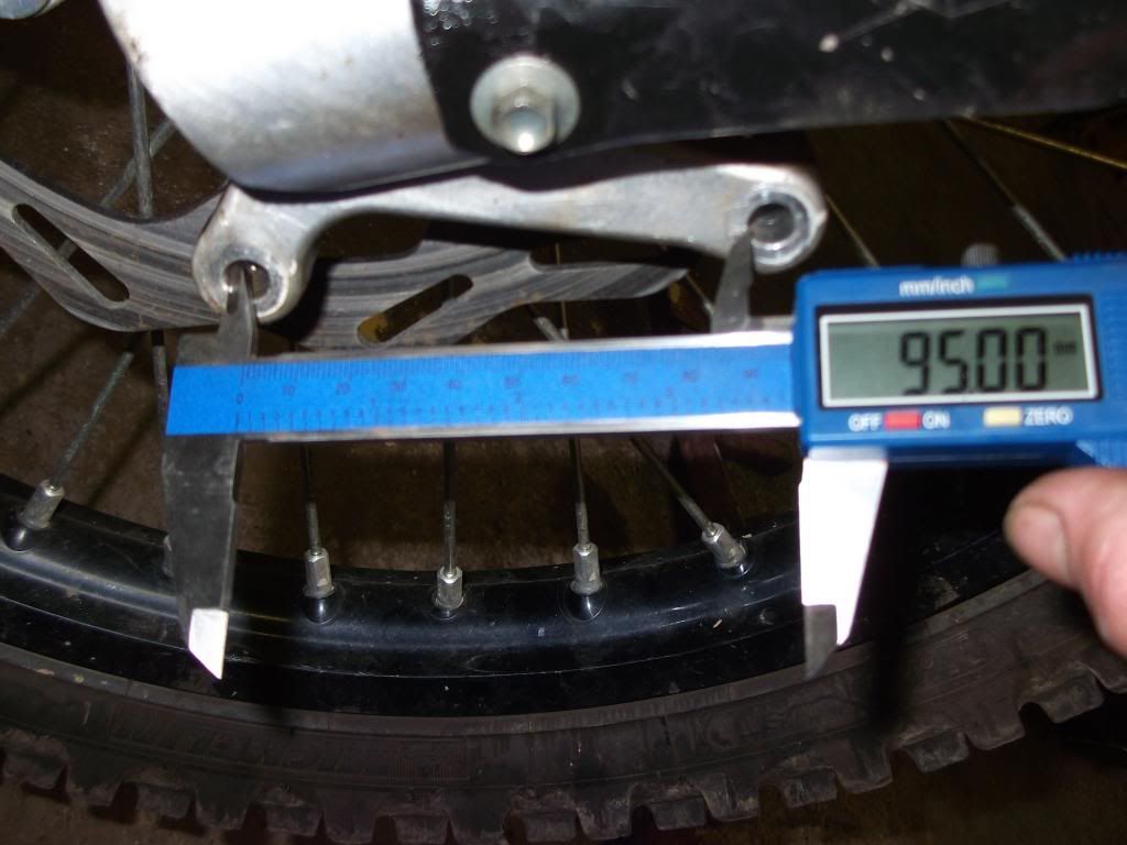

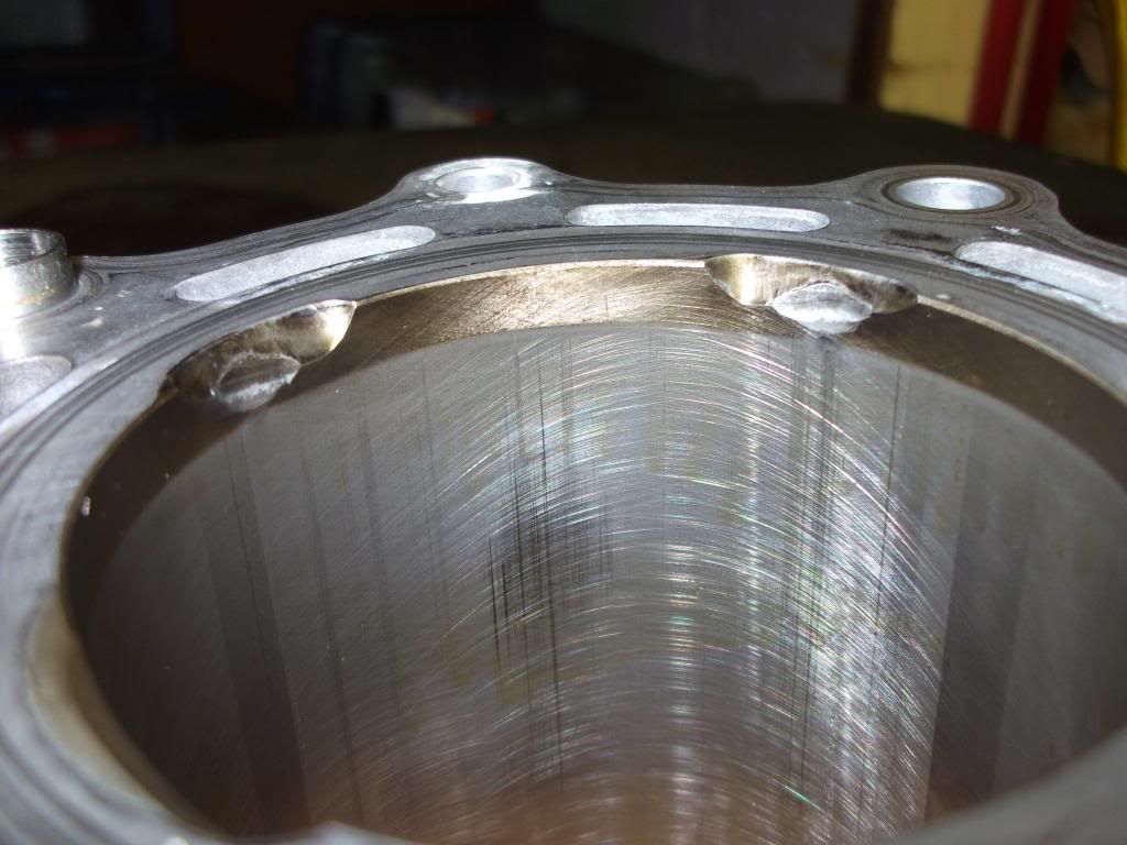

A few updates, I spoke with maxrpm today about the engine and they are sending me specs, the motor was debored and destroked I did confirm (centerline of rod moved on the crank and the cylinder was made smaller). I am now dealing with trying to find a front brake set up. I see a lot of bikes have a 60mm center to center spacing on the caliper bracket. I need the larger 95mm center to center spacing which is proving harder to find. The cylinder head is cracked and I am searching around for the best place to get it fixed if that is even an option, I do not think I can lose any deck height on this motor, valves have already made contact with the cylinder wall. See pics. If any of you guys know where to find a used front brake set up again I would appreciate it. I am contacting sellers on eBay hoping I can find one that will fit from a different bike.

Spacing for caliper mount
Valve clearance, but not quite enough. Whole seperate issue
