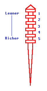

According to JD's recomendations my jetting should have been right where I had it except I should have a 180 main jet so I changed the main, installed the leak jet, red needle in the 5th from top position and the heavy o-ring.
Results were a bit more bottom end snap which frankly I attribute mostly to the new exhaust, bike fell on it's face above 5000 rpm and my gas mileage went to about 35 mpg.
Next I changed back to the factory needle with no decernable difference in performance but the mpg improved slightly.
Changed back to JD needle 5 th position with a 178 main and everything improved although it was still not pulling as hard at higher rpms and mileage is only about 40.
Raised clip to the 4th postition and regained some of the topend hit and getting close to 45mpg now (depending on how I drive of course).

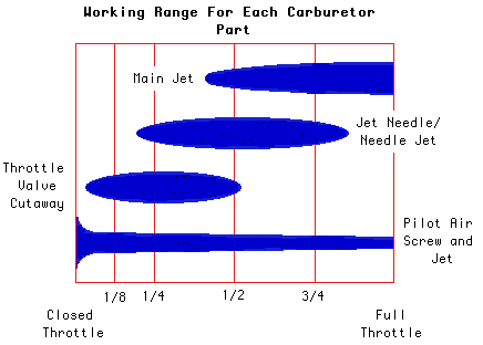

http://au.geocities.com/ozcross250/needles.html
Grasp this first.
Thanks, Michael. Interesting read. My problem/challenge is that I'm between two circuits and I guess I'll just have to do the trial and error thing thus far since I'll have to put it back together to do the test. I was hoping to find someone that had the same issue with a TE that did one thing or the other to correct the problem. I'll be a lot smarter after I ride it...post the needle change.

The key is trying to figure out which part of which circuit your deficient in.

Honestly Doug I went through a lot of trial and error with mine trying to find the perfect setting. If you set it up just like I outlined you will be so close that you will never look at it again. No mid range stumble and very minimal decel popping ( only occassionally ).
