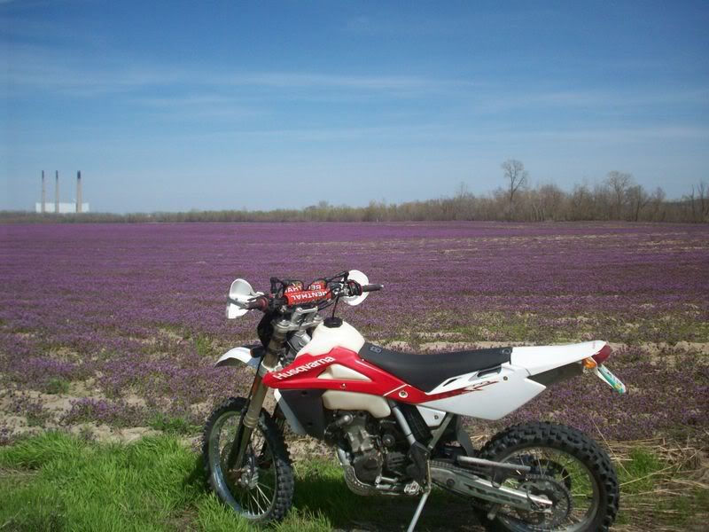

Easy to install, great fit, & exceptional range. I average 40 to 45 mpg's. I take it off & run the stock tank most of the time, a little less top heavy on the trails that way. Yes it is the 3.9 gallon. Only thing I don't like is running out of gas when there's still plenty left in the right side. Have to lay the bike on it's side to get the rest out. If I could do it easily, I'd put another tap on the right side.
