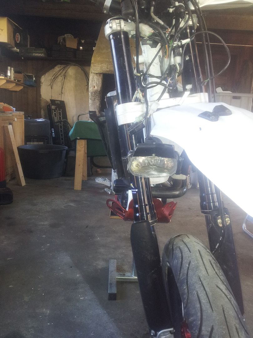

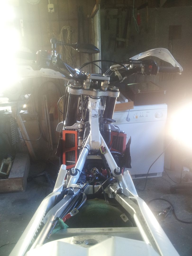

Picture of the bike the day I got it
And a picture of the bike after the crash..

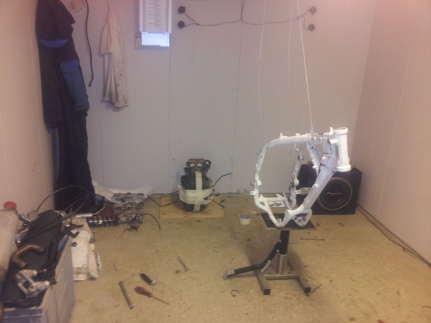

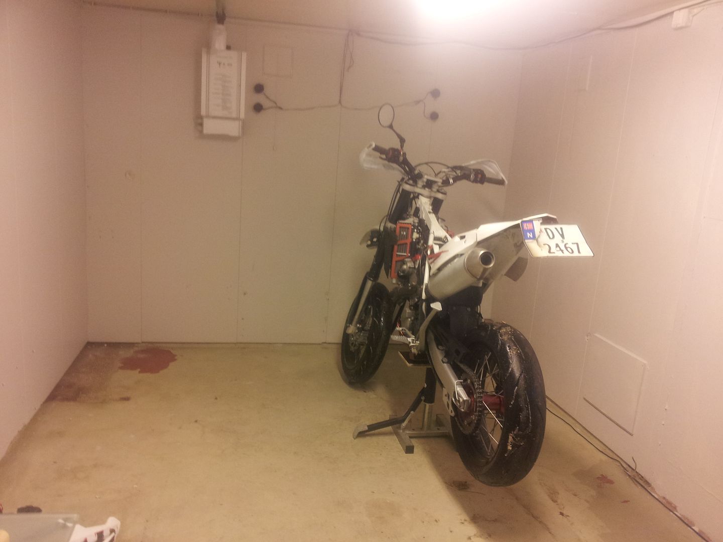

Been painting and cleaning the room I'm going to be "living" in this winter, but I'm still waiting for most of my tools to come. Wasnt able to get any paint for the concrete floor since the only paint they had left was blue.
Rather smal room but think it'll do just fine.

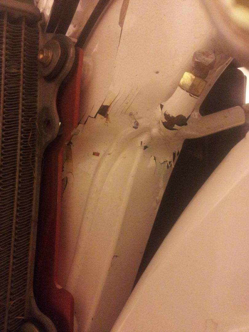

I belive this is where the frame took the most of the beating. the whole area is bendt in.

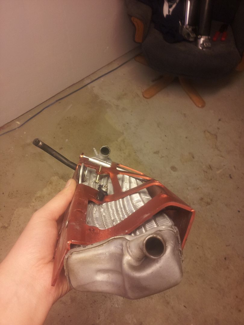

Belive I might need some new radiators.

Anyone got any ideas for new radiators? Should I buy stock or upgrade to something else?
Thinking of getting the same radiator guards that I had, but dont know if they'll fit if I upgrade the radiators?
Thinking of getting these Fluidyne radiators: http://www.ebay.com/itm/HUSQVARNA-3...Parts_Accessories&hash=item53ed53e6db&vxp=mtr
Hopefully the frame twisting didn't move your engine mounts. I.e. just enough that it might cause trouble when putting the engine in the new frame, the motor is a pretty solid unit though so hopefully you are ok. Also even if you could straighten your radiators I would be a bit concerned that they might have been too stressed now and might fatigue over time and not hold pressure.
Yeah, the frame only seemes bendt above the engine mounts so I believe that wont be a problem. Dont think the radiators is something to straighten, so going to buy new radiators.

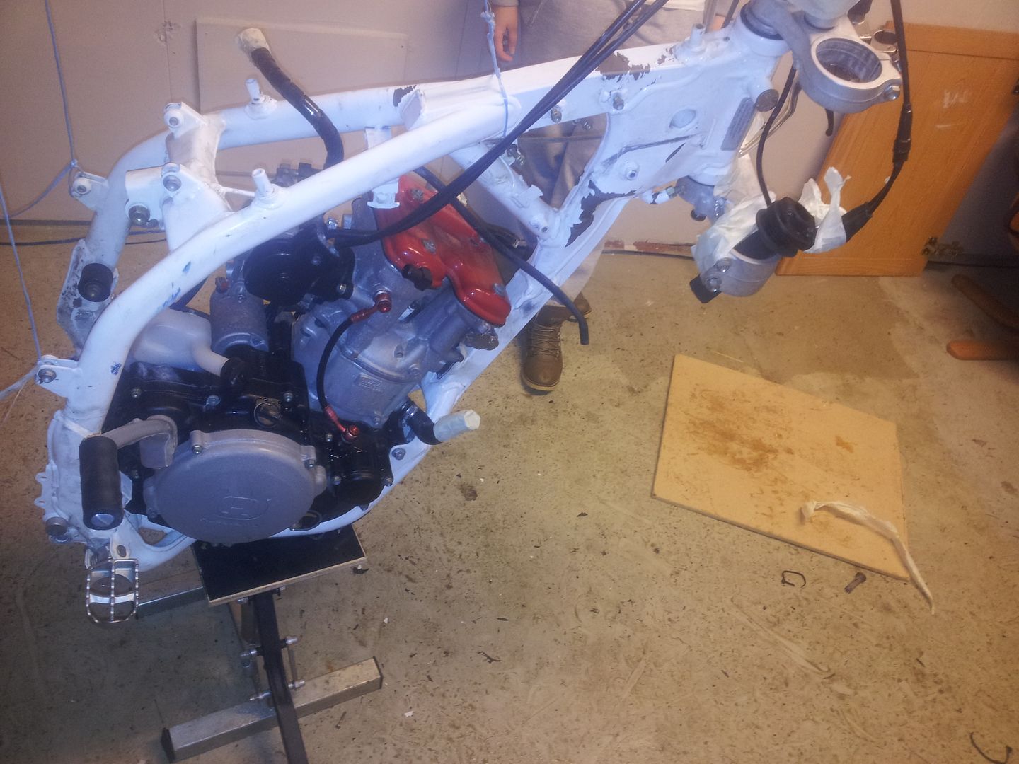

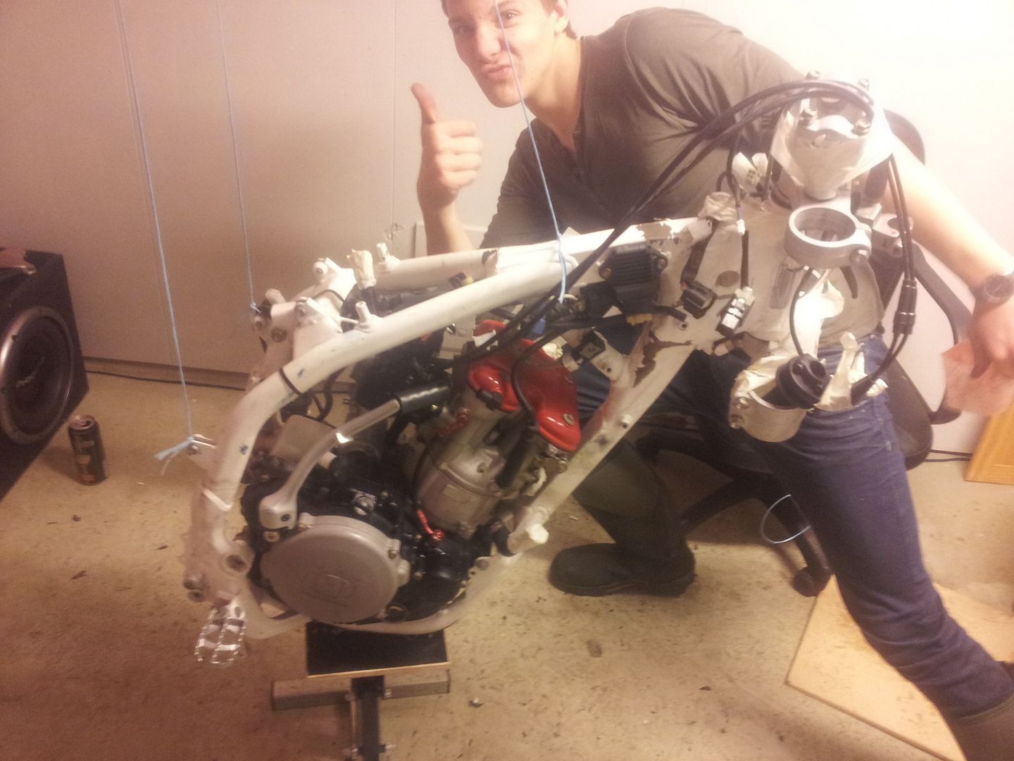

Not much left of the bike
Aaaand it's all gone, the engine mounts was a little bit bendt, but it was no problem getting the screws out. And I'm ready for my new frame. Which i hope to get before christmas.
Looks good man, good luck.
