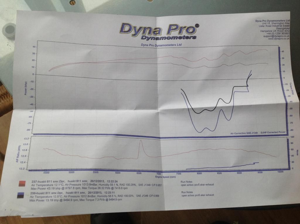

After being disappointed with the performance of the bike with race map 3 I purchased a Power commander 5 and tried both of Ziptys provided race maps (Big thank you to Tinken for providing these) the difference was night and day. Knowing that Zipty is 1000+ meters above sea level and I am only 250+ I thought it prudent to get the AFR checked out on a dyno. So myself and 2 friends went yesterday.
My bike has the Akra end can, TC airbox lid, PCV with Burson map installed. Below are the results.
Looking at the AFR it looks like it could do with a little more air, is there a race airfilter we can get for the 449/511?

Bikes run
Husky 511 SMR with Akra end can, TC airbox lid and PCV 43 bhp
KTM 690 with Cam work and Leo Vince exhaust 51 bhp
Husky 510 standard 47bhp

I'm wondering if I can lean the percentages out a tiny bit on the burson map to bring it closer to 12.5
The "more holes" just brings it a bit closer to the way the TC's airbox is made. Sounds like putting a TC's lower airbox is a fairly common mod for the TE's. I don't know if bottom end is lost, but I'm fairly sure it will lean out the bottom end which means... in my opinion, one should have a PCV to richen it up or the added air flow will mess up the way it runs down low.
