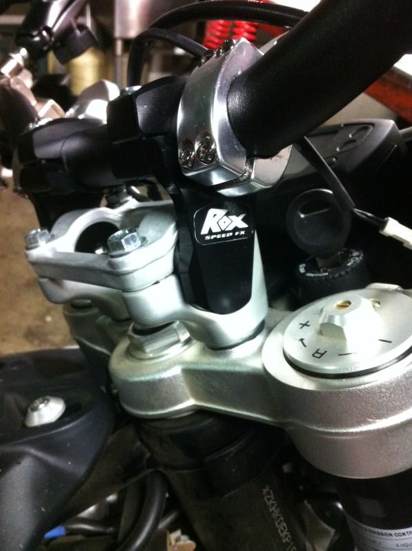

I got some dropper plates made up so that my pegs are 20mm down and back, 30mm bar risers are in place, but at 6,3" I am still not comfortable when up on the pegs, so has anyone fitted aftermarket bars that give greater height than the standard bar? Thanks in advance for any advice.
Did you also change the gear shifter and break paddle. Because that drop........ I am thinking, would make your foot an an awful angle.??

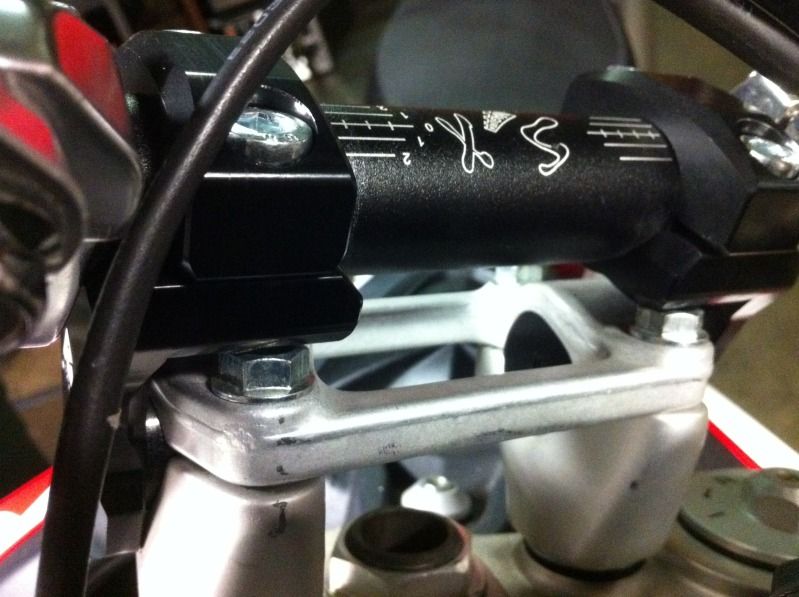

I'm 6'5 - The rox makes the bars too high and it won't turn quickly on dirt. I have 30 mil risers and renthal high fat bars. perfect. (oh and also peg drop plates). I've had a lower gear shifter made my www.motosupplies.com and they also cut off the brake foot and put on a lower pivoting foot. I can't provide pics right now as the bike is having forks from a ktm 950SE which needs new yokes and spindle etc and it'll be a week or two.
Zombie thread- I know... Anyway I did the shorter Rox and I love them. I'm 6'4 and standing on the pegs has gotten about a million times better with these. I'd agree that the steering on the street does feel different, and probably slower, but I'm real happy with them.
I have the same and noticed that with the bars too far forward you get an over steer on the street / hard pack. I keeping about 3/16" off the front bolt clamp.
