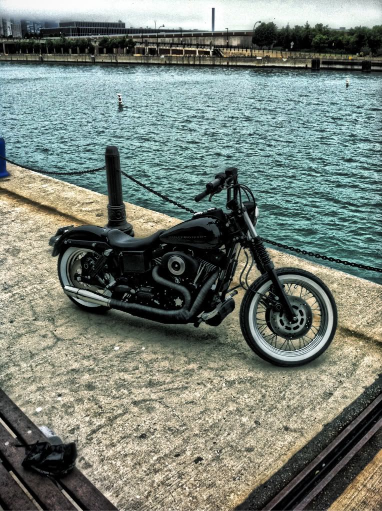

Here's what I did when I had the hacked-on FMF on mine:
The little carbon shield is a Moose universal shield. It's just held on by a couple hose clamps. It sits right where your leg would normally contact the pipe.
I didn't like the look of the stock guard either so I painted it with hi-temp low gloss black paint and it's held up for over two years. All you need is about $10 in painting supplies to get the job done.
That's probably the route I'd have gone if I could still use the stock heat shield with that FMF. Just blackening it goes a long way toward making it look less huge.
I was lucky I had no problems doing that with my Leo Vince pipe. The cover really looked put of place when it was silver.
I don't know if it was the right thing to do, but while I had my stock shields in the house for black-out painting this winter, I covered the inside of the shields with adhesive backed Thermo-Tec. (I hate melted pants.) I also used some 1x3 thermo sleeve on the wire that runs down the front downtube frame near the header.
