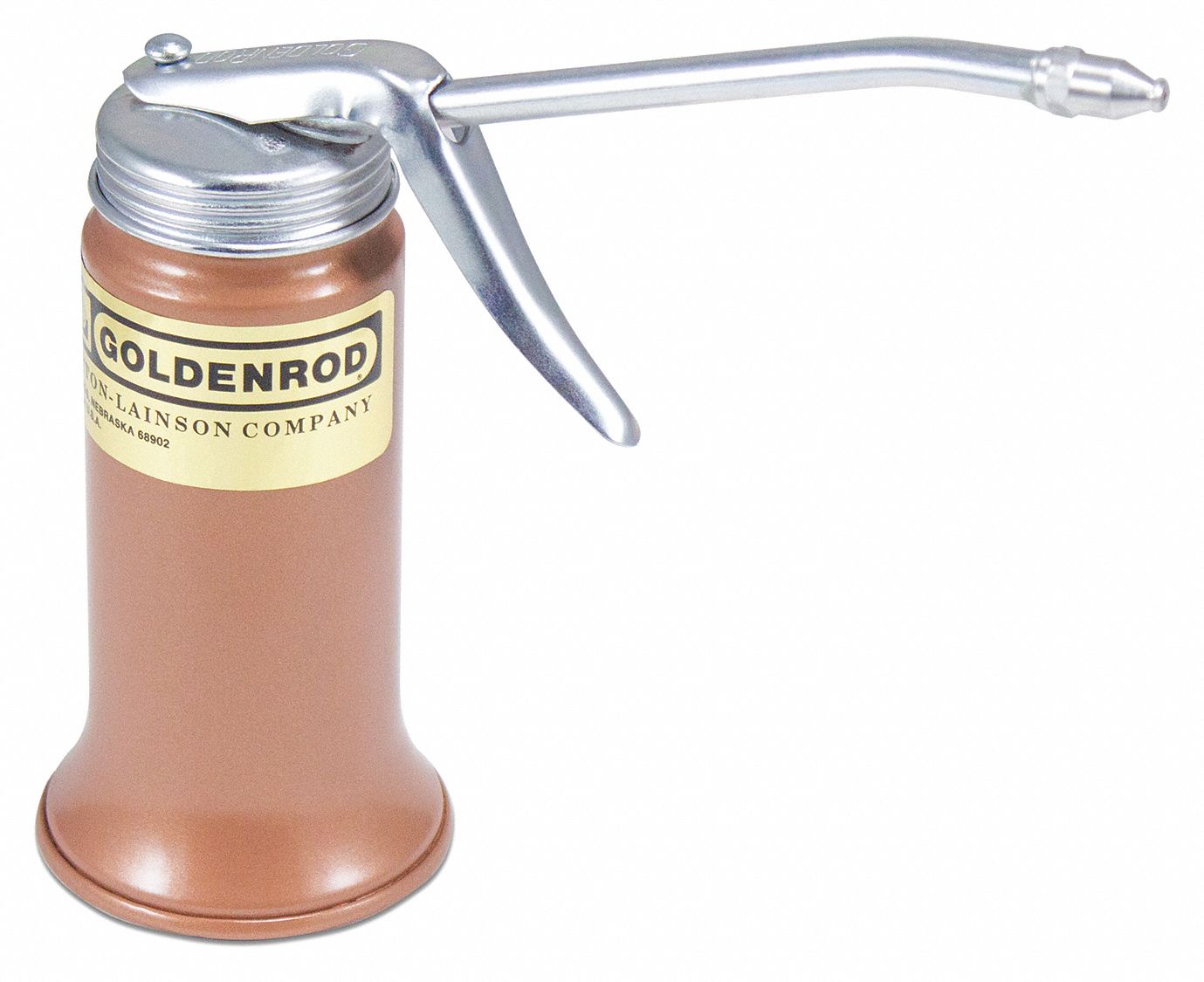

I recently used this old school style oiler to bleed the clutch on my Beta 525, it was a lot easier to handle then a syringe. I put a length clear hose on the end of it to attach to the bleed nipple. With the can, I am able to hold the hose firm on the bleed nipple with one hand, and pump the oil can with the other. Works like a charm and not too messy.
