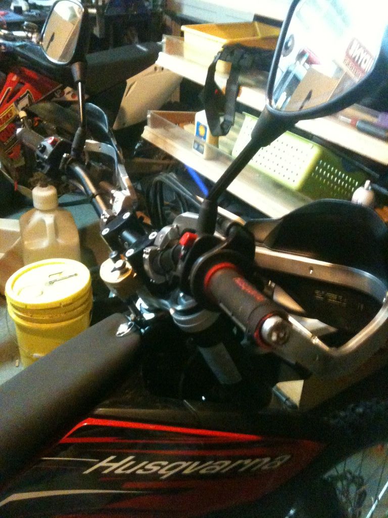

I had a fall on my '09 TE510 today and now I have a few scratches and bruises, but worst of all, the handlebar mounting clamp has twisted, along with one of the mounting bolts.
I am thinking of replacing the whole lot; clamp, risers, bolts and bushes and I hope someone can suggest some suitable parts. Possibly some alloy bushes to stop the twisting in the future. I looked at Billet Racing, but I am totally confused about which parts are appropriate (do I want Bar Mount or Sub Mount, and which specific of those?). I also looked at Renthal, but they don't seem to have anything for Husqvarna.
Anyway, I'd really appreciate it if someone in the know could clue me up on the right parts to get me going again. Cheers.
Here is the damage
I would go with a Scotts sub mount and you will be steering dampener ready. It will give your bars a 1" rise as well. Comes with bolts and is as strong as they get. The whole lower mount is CNC out of a block of aluminum , it won't twist.
