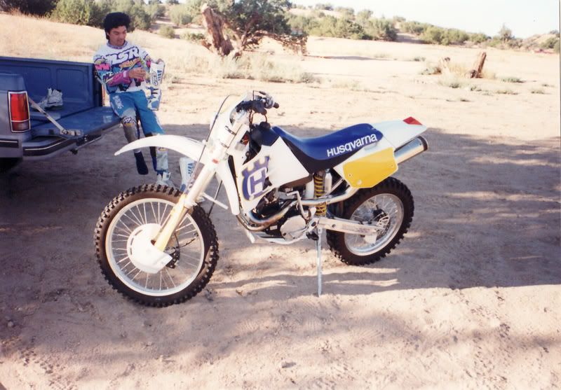

Here's my '93 back in the day with an Uptite pipe.
Uptite Husqvarna (George Erl)

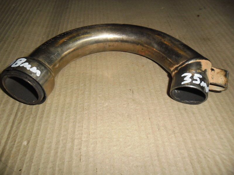

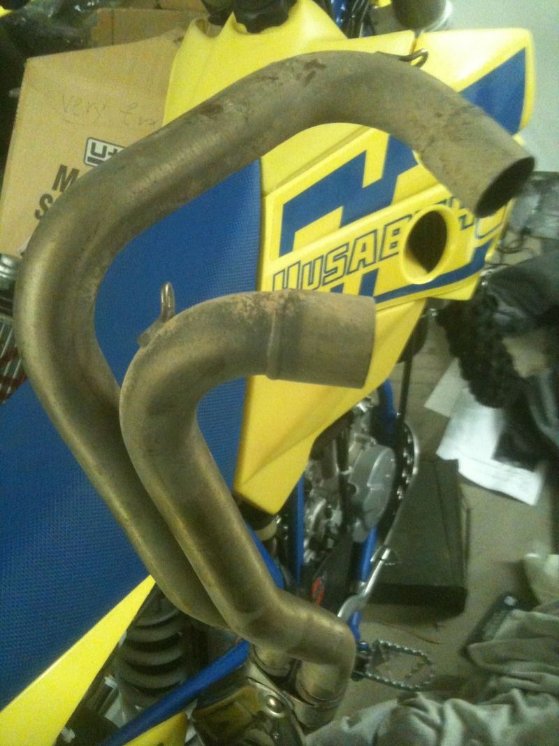

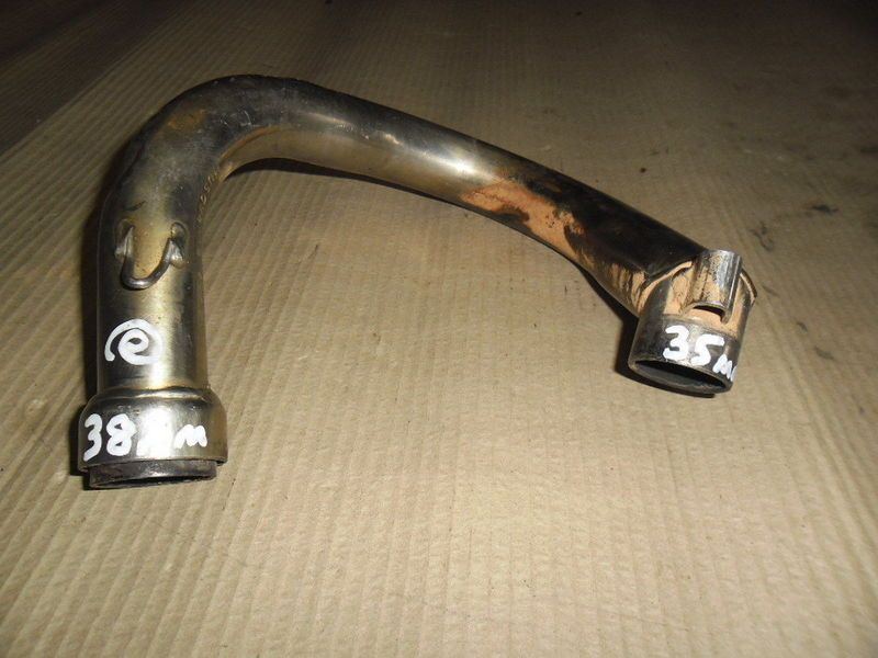

The headers on the '92-'99 are very large diameter, but start off at a sharp angle. I'm not familiar with any older Euro brand pipes, but the Uptite header has much better flow, slip ons I've tried that use the stock headers are pretty limited. I may have even lost a bit of power with the Big Gun.

I don't have an Uptite nor can I find a photo of one off of a bike, but here is a bad phone pic of a stock 2000 header (excuse the Berg). Notice the improved angles, it is better than the older larger diameter down angled header, although the muffler is pretty heavy and restrictive.
The Uptite has an even smoother bend if I remember correctly. Dirt Bike did a pipe comparison on a '99 YZ400f and the Uptite smoked all the other pipes in power output but didn't win because it was too loud. I think it made like 5HP over stock on the YZf and a good 2 or 3 more than the others.
