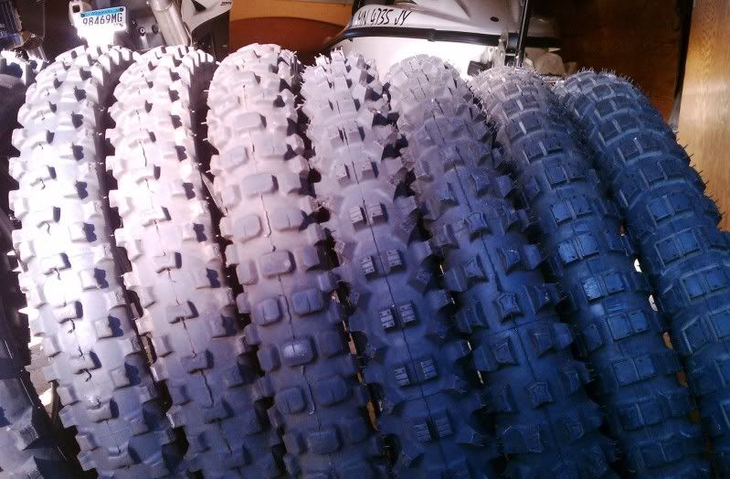

2 on left..25% worn Comps MS, Then 30% worn MT21, then Michelin comp IV (best of the bunch for sand), then Desert and the stockers

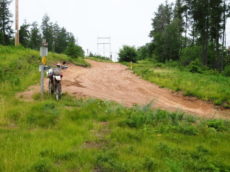

Terrain I'm making comparisons about
Michelin Comp IV
http://www.michelin.co.uk/motorcycl...lector=true&category=enduro&fromTyreSegment=5
Michelin Desert
http://www.michelin.co.uk/motorcycl...tor=true&category=rallyraid&fromTyreSegment=5
Michelin Enduro Comp MS
