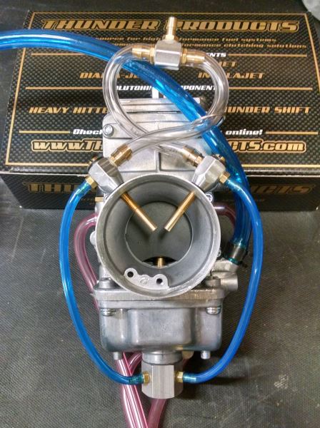

If you’re using the Pro Mount, measure per the instruction booklet and drill through the bell of the carburetor.
Use the supplied tap and thread the aluminum hole carefully.
After threading the nozzle securely into the carburetor, install the float bowl drain screw adapter and the fuel supply line.
Attach the other end of the larger hose to the fuel-mixture module and then run it to the nozzle.
When it’s all set up, it will look like this, ready to mount on the frame.

To correct that, Evan Hoge (builder and also Klim Product Line Manager) is counting on a little magic from Starting Line Products and Thunder Products. SLP modified the carburetor as part of its cart-engine build on the CR500R powerplant. And to help the bike adapt to the cold air, fluctuating barometer and rapid elevation changes, Hoge is installing an Intelajet system from Thunder Products. In a nutshell, the Intelajet adds two nozzles that spray an additional fine mist of fuel into the carburetor's airstream--all adjustable by the rider via an external knob. Hoge will be able to make adjustments to the fuel delivery quickly and without tools.

so does this work really any differently than a lectron powerjet or a mikuni dial-a-jet? seems to only work over a set throttle opening like 50% or so.
Yeah except the fuel is emulsified with air. I had the predecessor the "Dial A Jet" they work good.
