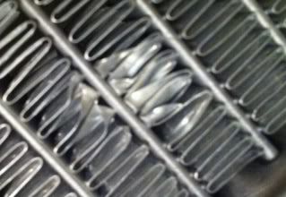

Hi gang. Last weekend my radiator went bust- seems to be a common issue w/ these Alexon radiators. A great dealer sent me one straightaway- can't thank them enough.

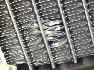

Now, upon looking at it closely last night I see some pretty significant damage to an area of the fins...enough to have moved a few off their tiny spot welds. This concerns me, obviously, as the old one sprung the leak along one of the downtubes where the fins meets it. If I close one end and blow really hard on the other it seems to hold pressure, but we know this couldn't be more inaccurate of a method.
I'm going to e-mail the dealer- he's great so I'll see what he says. I'd really like to repair the bike tomorrow (which is why I paid for 3-day shipping) to recover a ride. I'm considering taking it to a radiator shop today to get it pressure tested- but I do not know what they should "pump it up" to (and then they see if it holds consistent pressure, of course.) I want to specify a range to them so they don't blow it.
If anyone knows the safe pressure range please let me know. Thanks!
