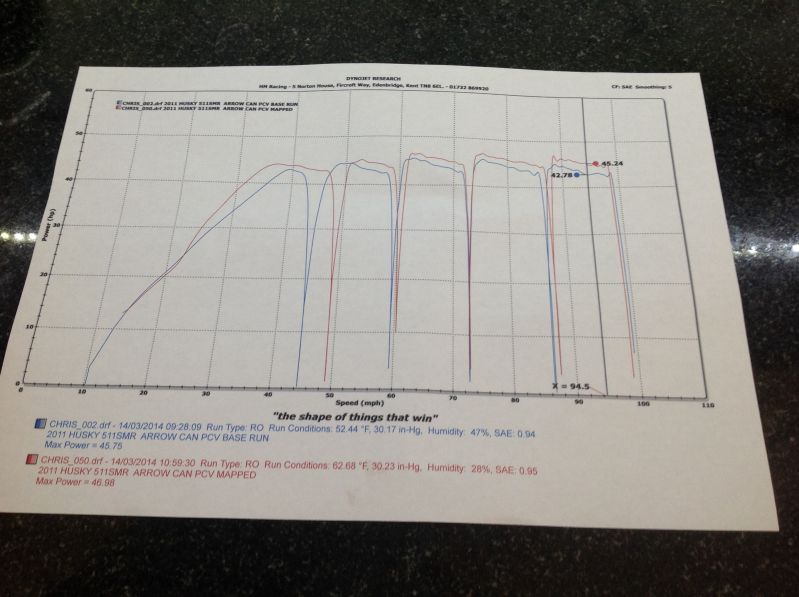

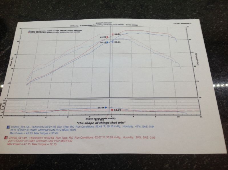

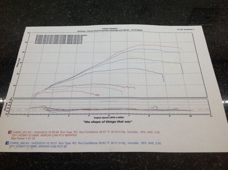

After running with the generously supplied maps from ZIPTY RACING I thought it was time to get a custom map for my 511 SMR. It's currently running these mods TC airbox lid, cooler spark plug, 0-40 Mobil one, arrow exhaust from a 510, ZIPTY breather kit/tank, quick action throttle and a PCV.
I took it to HM racing as they are well known for tuning and racing huskys.
It took them 2 .5 hours to create the custom map and originally I was disappointed with the final figures but as soon as I rode it I couldn't of been happier. Throttle response is so crisp, the mid range torque is a lot stronger than before and it also doesn't spit as much when you roll off the throttle.
