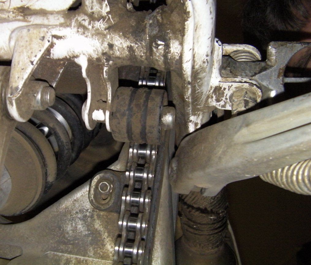

Lower chain roller mount broke and of course the roller is gone. Two things:
1. How bad is it to ride it with no bottom roller. Was leaving in two days for a trip on the bike. All street with no offroading.
2. Can someone take a pic of the mount with the roller intact for me. Never really looked at it so I'm not sure how to going about welding something back on that would work.
Not the chain guide near the rear sprocket but the lower roller near the counter sprocket.
These pics are a little fuzzy due to low light but I think you can see what is going on here ... These are from my 010 TC250 so yours might be slightly different ..
The chain seems to rest on the roller some at rest and not sure what happens with this roller under load but I'd try to rig up something before riding hard as a chain de-railing at high speed can have bad effects ..
View attachment 23436View attachment 23437
Shoot. The part it threads into is totally gone. Only the arms of the bracket remain. Will have to get something welded on there. Thanks for the help guys.
Is the upper roller more or less the same size. Don't have time to get another so may have to rig the upper roller to the lower as the lower seems to a bit more important. My upper roller doesn't look like it's been touched.
