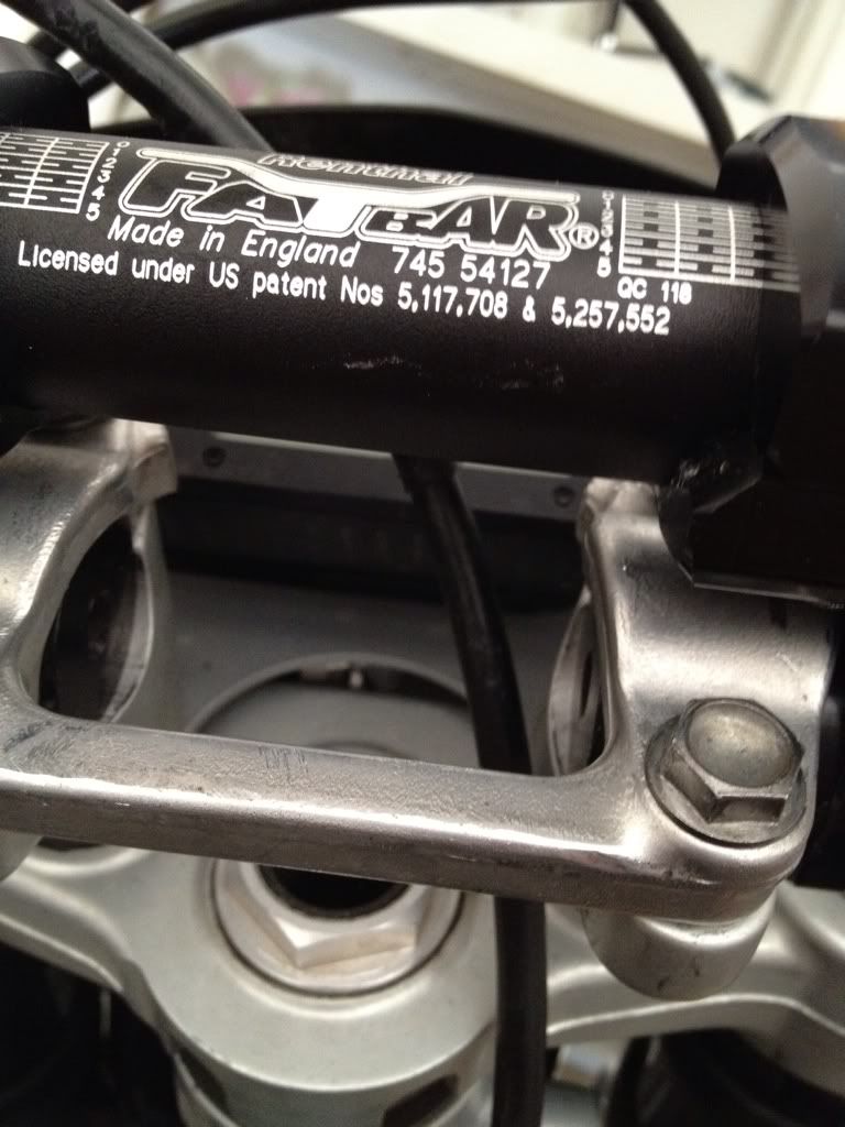

My second question is about the handlebars. Something was bent and now they have a strange angle. I'm think it is the silver part pointed at in the following photo. Where can I find parts like that?

As far as the bars go, it might be a little hard to explain, but you probably just need to tweak the bars a bit. Each riser bolt goes through a rubber bushing that helps dampen vibration but allows the bars to twist a bit in a get-off. Loosen the nuts that hold the risers to the triple clamp. I believe the heads of the riser bolts will be captured in the riser. If so, you won't need to pull the top clamp and bars off the risers. Next, loosen the top clamp. Then you should be able to line up everything straight ahead and tighten back up. You may need to hold the front wheel while you reposition the bars or knock the front wheel into a fixed object like the leg of a work bench or something. I've had to do this a few times myself.

I'm going to try the handlebar fix. Your instructions are exactly what I needed, so thanks! I'll try it this weekend when I get some time.

Your bars a off because the top clamp is tweaked. I had mine off yesterday and during inspection I noticed a very slight bend. I tried to hammer it flat, but that didn't really work. I even tried heat, but to no avail. So I did this
and it made all the difference! My bars are perfect now. Just look at the clamp and figure which side is bent and cut that cross section off on that side.
I'm going to look into the clamps as soon as I get some time. Thanks to you folks, there should be two ways to go about fixing it. I might be asking for more wisdom from somebody once I dig into it.
