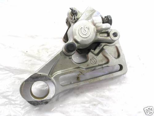

My back brakes are not engaging. There is a good bit of padding on it, but when I push down on back brake pedal , brake light comes on, but the pads aren't moving at all.
Could someone pleasehelp where I should be looking and adjusting??

Make sure the rear caliper moves freely side to side....clean caliper pins if needed.

I believe the brake light is activated on fluid pressure, if that is the case and the ligh is working the issue may be a frozen caliper or caliper pin not allowing the pads to engage. Note that the light actuator does not need much pressure to work so no promises. How does the pedal feel? Is it going all the way down with little to no resistance. Can you pump the brakes to build pressure?
^^ i'd start here. if the light is working via the rear break pedal you have to be getting "some" fluid pressure. problem exists at the caliper IMO.

Also - does the battery / bike need to be on in order for the rear brake to engage? I don't have much time now but will look again this weekend. What is the caliper? Look like or attach to? Sorry for noob question, not familar with this part of bike.

the caliper is the part on the swingarm, that houses the brake pads that the axle goes thru.
