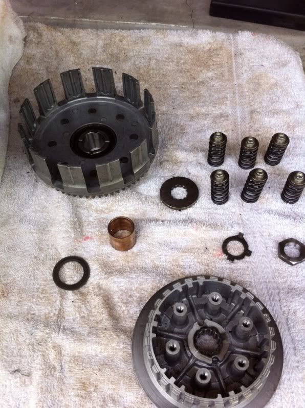

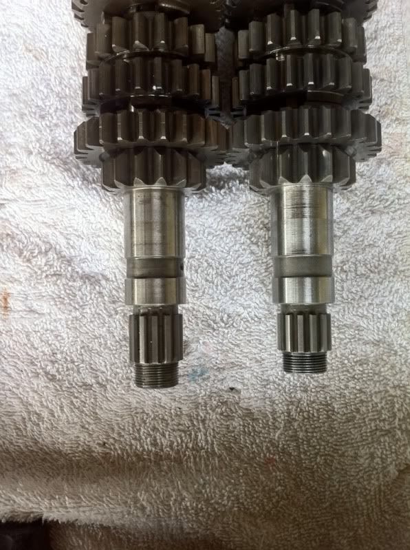

Sorry to say it won't work. The gear can't be replaced on the 04. And the newer basket won't fit. It fits the shaft but the teeth aren't the same. Also the shafts are different lengths. But that can be fixed easily. But anything can be done. Just depends how bad ya want it.
Thank you very much for the reply and pictures. What about it I replaced the matching gear on the crankshaft from a newer unit as well so the gears would mesh correctly so I would be using a gear set-up from an 06 model instead of the 04? Does the 04 model have the longer or shorter shaft of the two? By the pictures it appears the bearing surfaces for the basket appear equal.
If you swapped the sprag clutch or some call it the starter clutch, then I reckon it would work. I do have a complete clutch assembly for sale. I had an idea to simply it. You could just have a new gear made for the new basket assembly. Or maybe a 610 has the same basket with the 04 gear ratio. Or instead of making a new gear you can have the new basket machined down and a new ring pressed on with the old ratio.

Now I know the shafts are different in length. I'm almost positive the 04 has the long one. Try to stay with me here... I'm willing to bet that the 05-07 will fit but you will need the 05-07 washer that sits behind the hub.

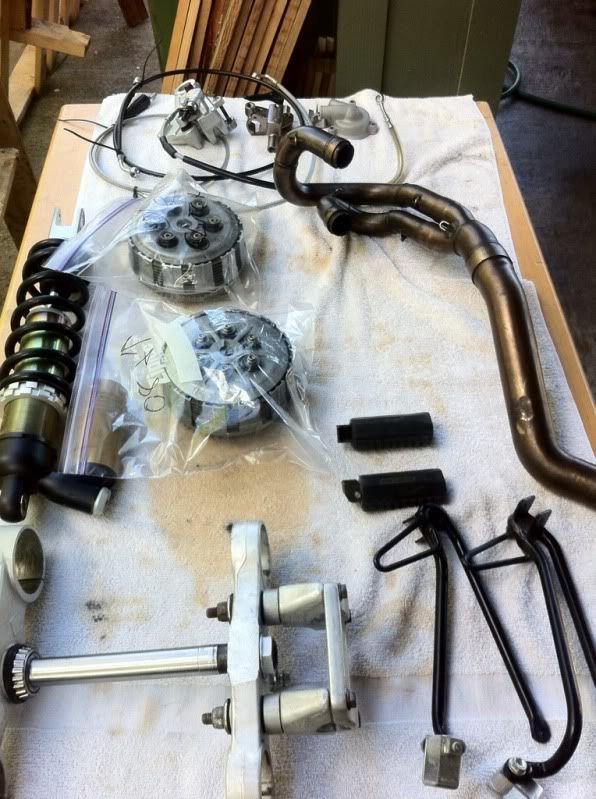

Dont know if you're still looking but Ive got a clutch basket with discs like brand new from my 2007 SM510R. The bike only had a few miles on it and had a slipper installed.
I've got a stock piston and rings from the 510 as well..
