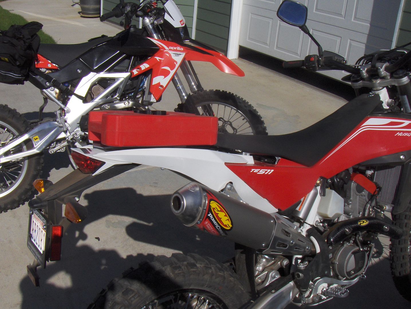

This weekend I went to hang out with some ADV guy's in the mountains of Northeastern Oregon and knew I had to get a way to add extra fuel capacity to the Husky I didn't want to have to borrow from the guy's that have tankards for fuel tanks.

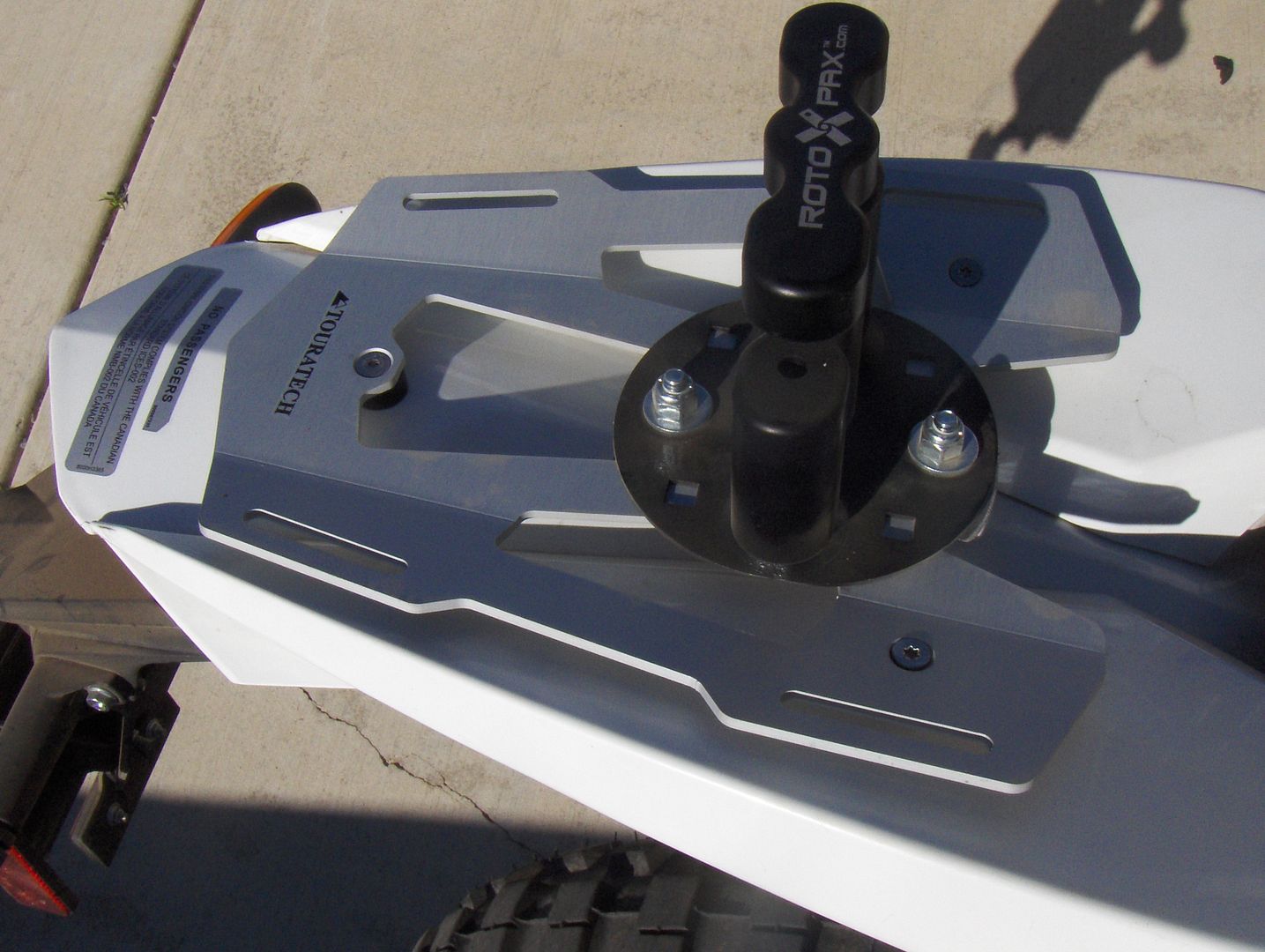

I already had the Touratech plate and just added the Roto-Pax setup. It can probably do a couple stacked pax but this trip I tethered 2 Wolfman 1 liter holders with the MSR cans to it.
I fabricated an aluminum plate under the rack because the stock mounting one would not fit.
I did some pretty tough trails and dry river rock crossings and it held up great.
Good Job, does it plug into the fuel system or do you simply take it off and pour the contents into the main tank?
It does not go directly into the main tank but takes all of 10 seconds to dismount the fuel can and top the bike off with the 1 gallon.
great idea; I've been thinking about something like this.
Does the rotopax intrude into the seat area?
