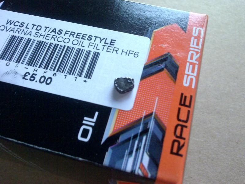

So I purchased the 511 SMR with 1500 miles on it, it came with a fsh, next offical service isnt required for some time but I like to keep my bikes serviced every 500 miles. So I purchased all the relevant bits and got to servicing it on the weekend. Apart from someone over tightening the sump plug and both metal filter bolts it went great until I found the below attached to the magnetic sump plug. Anyone got any ideas what/where it came from?
Does not look good. Engine make any noise? Maybe look at the torque limiter that is said to fail sometimes on these. It is located on the clutch and should be EZ to pop the cover and look at it.
Cheers, engine sounds great no rattles or knocks. Ill check the manual for the torque limiter location.
Certainly not a bearing or bearing casing fortunately, looks like it was a flat piece of metal so that should narrow it down, certainly worth popping the whole clutch cover off and having a look inside if nothing there then pop the rocker cover off, if nothing there ride it like you stole it and pretend you never found it.
