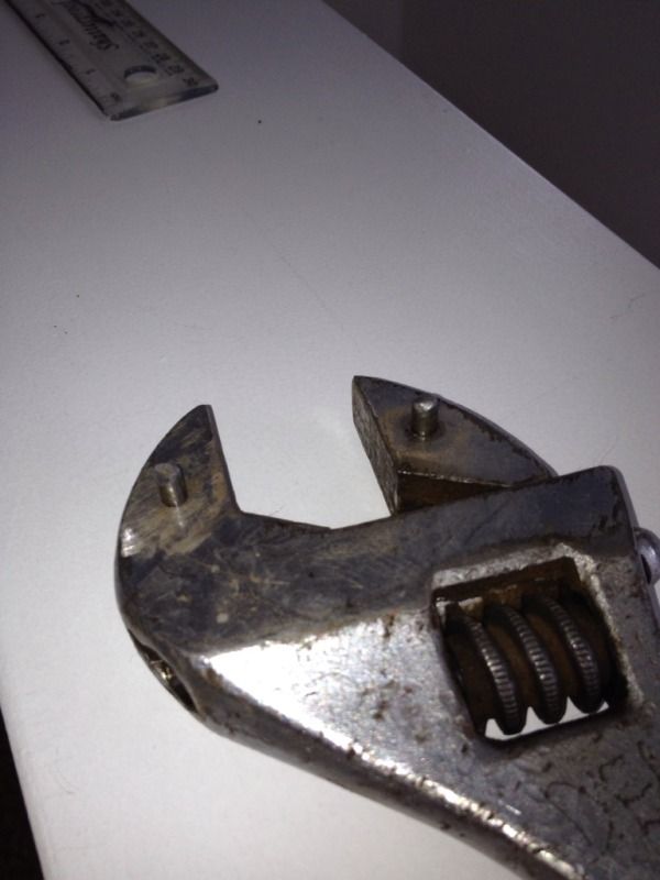

Sorry to hijack this thread, but I need to change my fork seals and it says I need a "4mm open-ended spanner to remove the lock cap from the fork leg".
Could someone please explain how the hell I do this and where the spanner goes? It makes no sense.

The spanner wrench goes in the top cap with the round and oblong holes all around it. One of the holes is filled with a rubber cap that has your fork bleeders under it. Don't stick the spanner in that hole!
I called a husky dealer, and they know of a tool for this off the shelf, and said they have an adjustable one from an auto parts store, or something like that...
JMetteer said the one that came with his angle grinder fit like a glove, but I didn't get that lucky!
I ended up making my own out of a crescent wrench
