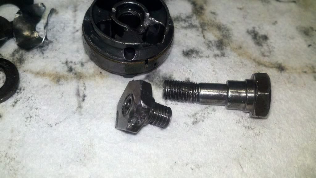

Just wondering if this is common?
I bought this bike used, and it had be revalved previously.

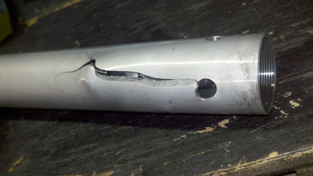

Both my seals were leaking so I tore the bike down to replace them. When pumping the dampener rod to force air out I noticed one did not get any suction.

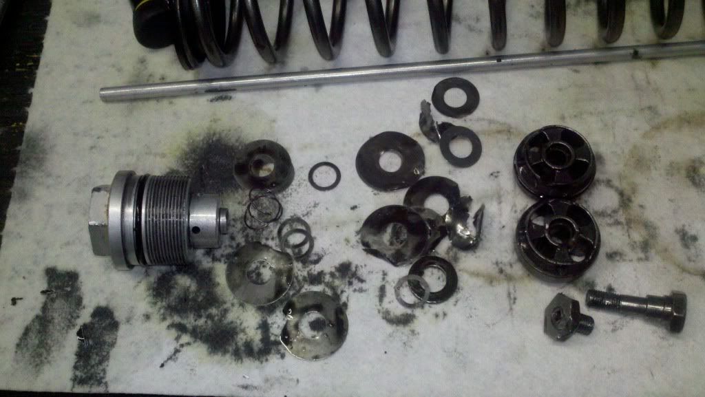

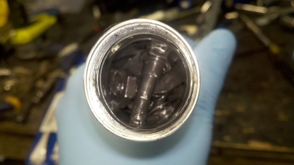

Upon tearing it down, I found this
Looks like eveything came loose and the bolt got jammed sideways and broke through the tube.
Anyone every see this before?

That's about as ugly as it can get ...

Oooh...that's nasty! I guess whoever revalved it, didn't fasten it down properly....plus, unless you want to run stock valving in both forks, you'll have to get new shims to match the valving on the good fork.:thumbsdown:
