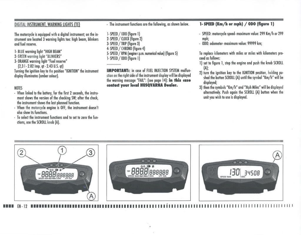

I have found in the owners manual that there should be a N come up on the dash when I put the bike in neutral but my bike doesnt do it. I asked the dealer where I bought my bike from and they could not tell me if the book was right or not and never got back to me about it so I just didnt worry about it. I recently downloaded the workshop manual and today found there is a gear position sensor next to the drive sprocket. I did the resistance test for each gear as discribed in the manual and the sensor is working fine but the wire goes into the ECU so I cant check it from there. Can anyone tell me if their 2011 te310 brings up the N when in neutral on the dash and given that the test has a different resistance for each gear I would imagine that each gear position comes up on the display screen. My bike is still under warranty so I would like to sort it out as soon as I can.
