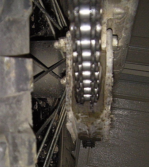

2) I was cleaning my bike after a ride this weekend and found that the inside of the chain is shiny. I looked a bit closer and found that the chain guide thing is also worn on the inside. There is an insert that was nearly gone. The chain looks straight and the wheel rolls smoothly. it looks like i need to get a new guide and insert for it. Is this a wheel alignment issue? Is this anything i should worry about? It almost looks like the guide is bent on the inside which would have caused this. (look at the last photo)IMG_1074.JPG

re #2: get a new chain and a new style chain slider. The new sliders are all plastic. Yours is obviously bent.

To be honest, it appears your axle block adjustment might be off a bit, unless it the bent slider causing the chain to be to one side of the sprocket.
My adjustment has always been straight and the rubber insert and alum box were wearing away the exact same way.

I went to my local dealer (Malcolm Smith Motorsports). They had the parts. The aluminum cage and the nylon insert were only $40 out the door.
I was able to get it fixed. The axle blocks were lined up perfectly. When I held the new aluminum cage in place with it flush against the outside mounting tab there was a very noticeable gap between the cage and the inside tab. ALSO, when flush against the outside it was still out of alignment. The chain was almost touching the cage just like in the photos I posted. I turns out the tabs were bent. With a bit of persuasion i got them straightened out. Is definitely not an exact science but the guide is near perfect. The chain lays right down the center in the front and is just a tad to the outside in the rear but not touching the nylon insert.
Thanks again to you all for the advise and opinions. :)
