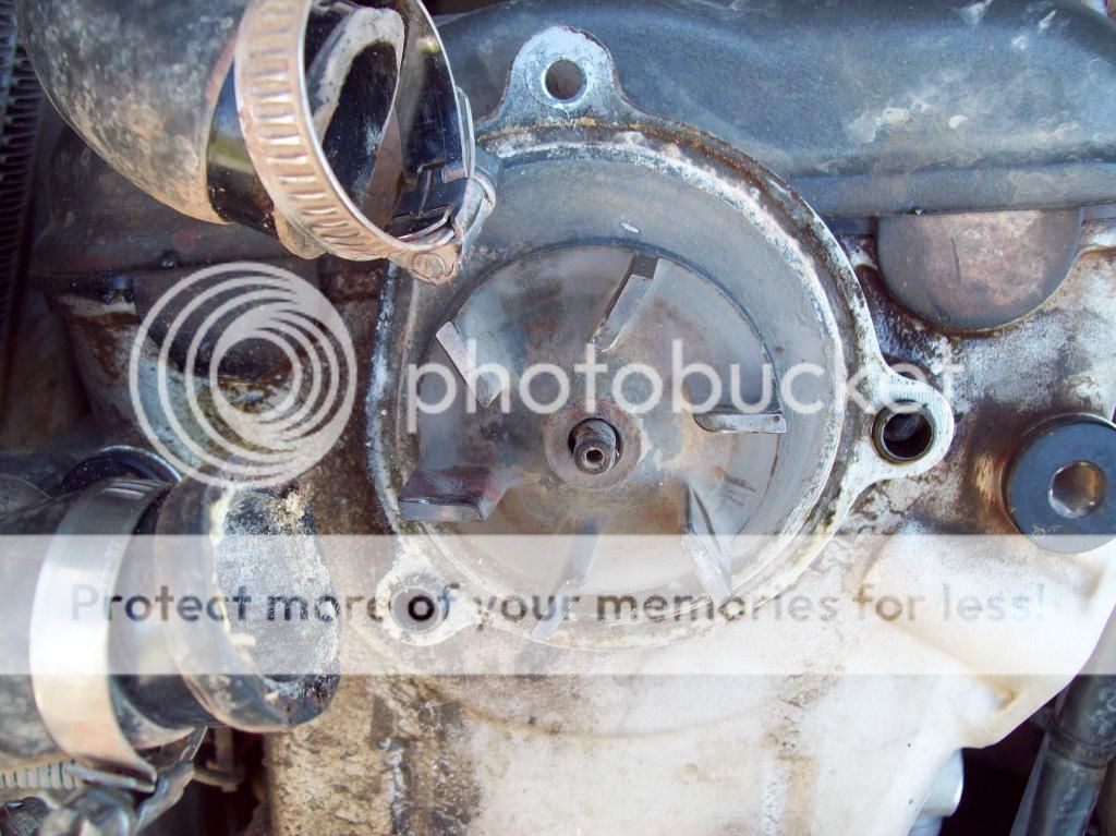

Hey guys. This has been such a helpful place for me. I hope you can help once again.
The impeller nut is missing on my 07 TE 510. It looks likely that it would have disappeared into the head. Do I need to remove the head or is the passage open enough for the nut to pass through?
Thanks in advance.
What I found when I pulled the water pump.
Take that lower hose off, the nut might be inside there. And then you can look inside the connection to the head, it might be resting right inside that opening.

I just pulled the upper and lower hoses and no nut. I am thinking about compressed air next. :thinking:
Can I use any nut the fits the threads as a replacement or is the Husky part special or particular?
The one off our 09 disappeared as well never to be found again. We replaced it with a stainless steel nut from ace hardware temporarily and then got an OEM nut.
Looks like it was a 5mm nut
STRIKE THE FOLLOWING REFERENCE TO 6mmShould be a 6mm nut with 8mm flats, you might can only get a 6mm nut with 10mm flats at the hardware store, but that would work OK. I've replaced several 6mm thread/8mm flats with 6mm thread/10mm flats, nuts and bolts on my bike.

See if you can find an aircraft/locking nut and it wont happen again

Now, should the impeller spin freely on the shaft or does it fit tight on the shaft and the shaft spins the impeller?

I got a small baggie of stainless locking M5 x 1.0 nuts at Lowe's. I put a small M6 washer behind the impeller because it looked like the impeller was binding on the cylinder head. If you guys think that is a bad move, I will pull it out. I snugged the locking nut up good and tight, but not too tight. I turned the motor over with the kick starter and everything turned with no binding.
So, I buttoned up the hoses and filled the rad with water and fired her up with the rad cap off. Water came gushing through, just like (I believe) it is supposed to. Great tip from another thread.

Since you are already in there you might as well replace the pump impeller with the high flow impeller. It comes with a free nut.
Very true. And if yours is like ours, the hole in the center of the impeller has probably rounded off some or completely so one way or another you might need to replace the impeller. We put on the high flow impeller and have never overheated again.
There is an o ring behind the impeller that needs to seal properly. If the impeller has too much clearance behind it, it can sometimes flex under load and allow water past this O ring. If you leave the washer in, check your oil frequently for water contamination. The oil will look kinda milky or chocolate milky vs the regular black.

I believe the washer is seated against the o-ring. But I will keep an eye on things as best I can. I do know what water in the oil looks like so I will know what to look for. :thumbsup:
