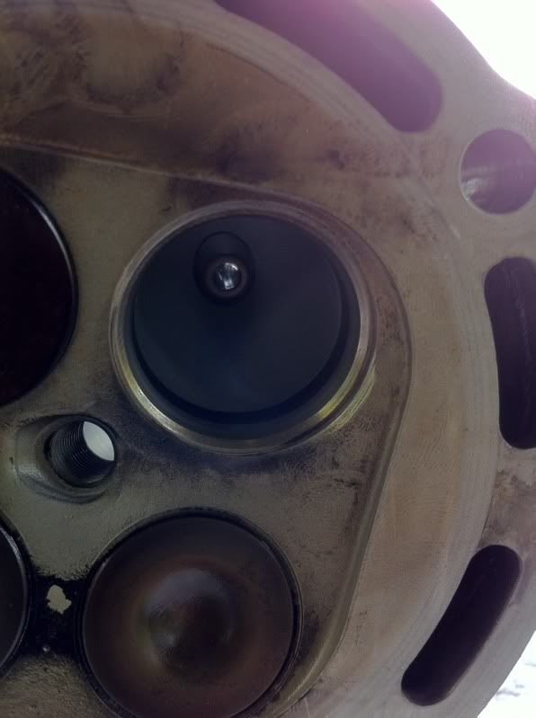

I did a complete rebuild on this motor. Bottom up ever seal ect. Ran fine until yesterday. Has a little over 100 miles on it. Buddy says it lost power. I picked it up and put it in gear. Pushed it and sure enough no compression. What might be the cause? I can't dig into it until tomorrow. My guess is bad exhaust valve.
My 08, and 09 did that. turned out the compression release was stuck. On the 08 the cable was just stuck from trash inside the cable.

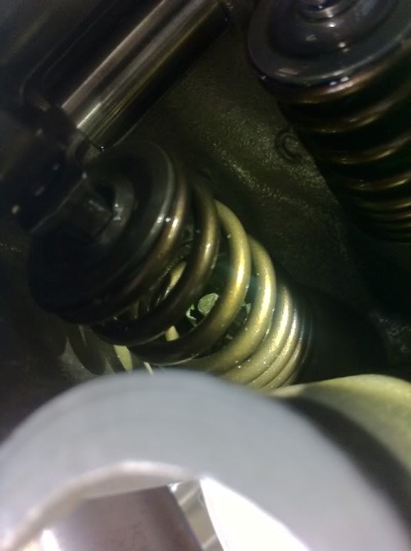

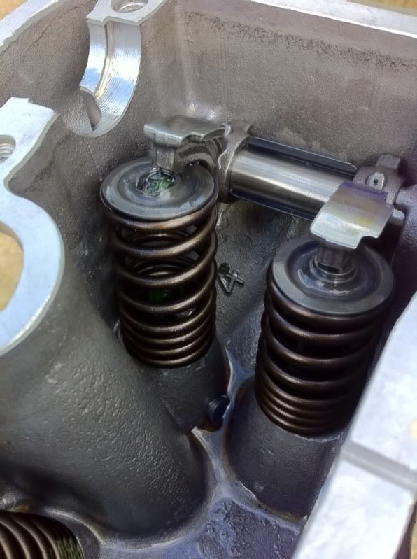

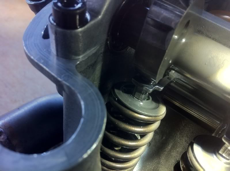

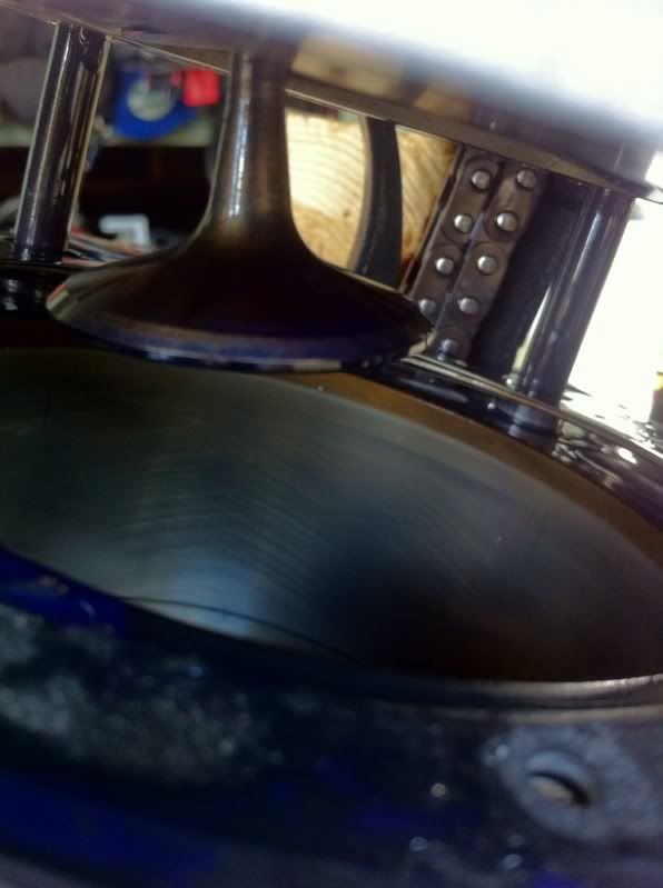

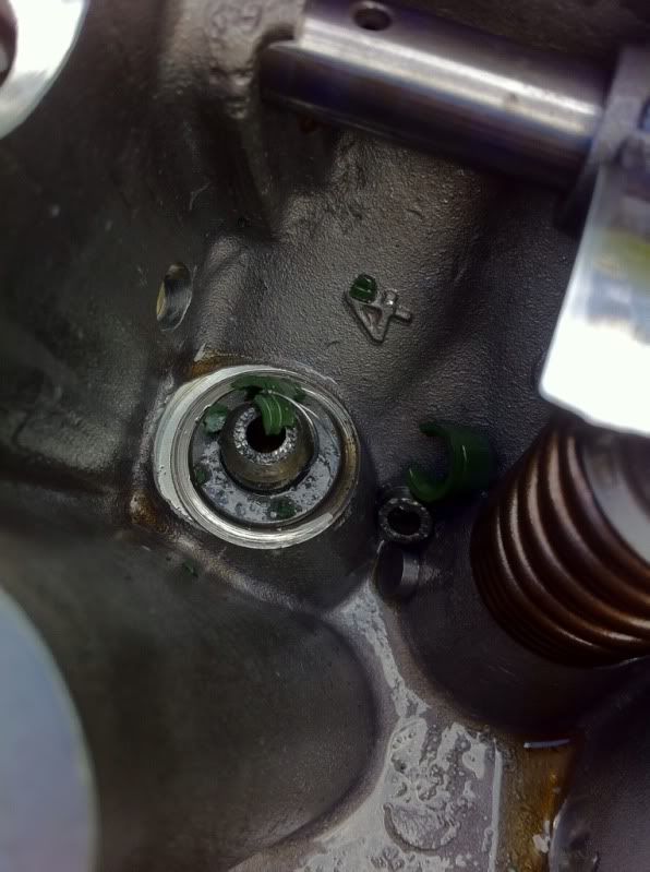

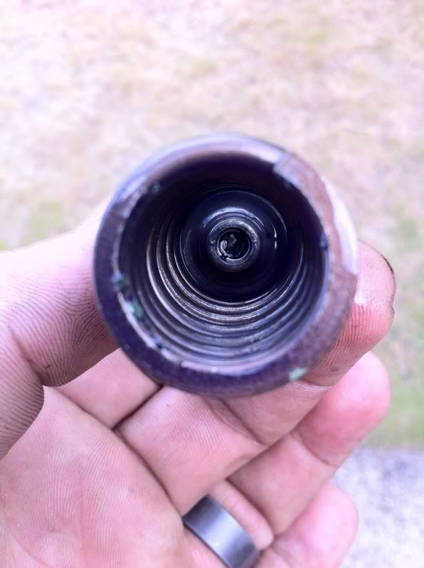

Found the problem. The intake valve is busted. It looks to be stuck in the seat. I pulled the plug and saw no damage. Drained the oil and no metal. This motor had a few hours on since rebuild. I know the 04's had valve issues so such is life. Guess he is gonna update to the 06 valves.
Well when I rebuilt the engine I sent tge heads off to be inspected Since I am no valve expert. It's my understanding that the 04's valves were a weak point. In 05 they updated them Then again in 06 to tge dell west. He will most likely have me send tge head back and get it updated to tge newer valves. Oh well shit happens. I'll post up more pics as soon as I can pull the head.
