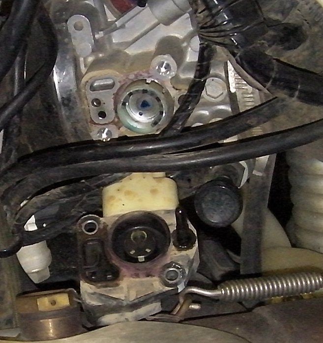

Here's a pic of the innards, when the throttle cable rotates the butterfly, the circle you see on the throttle body rotates inside the TPS housing(laying down).

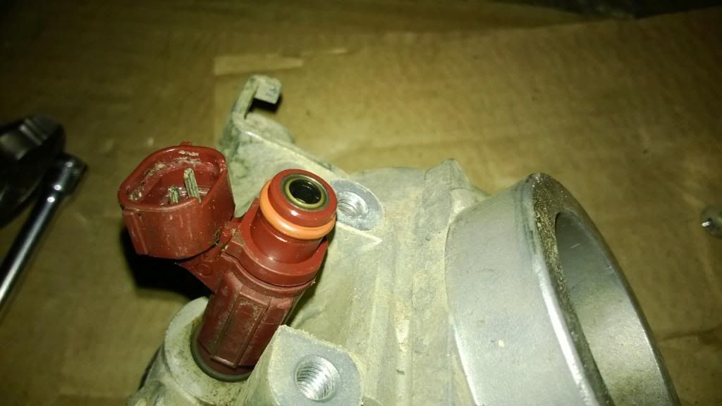

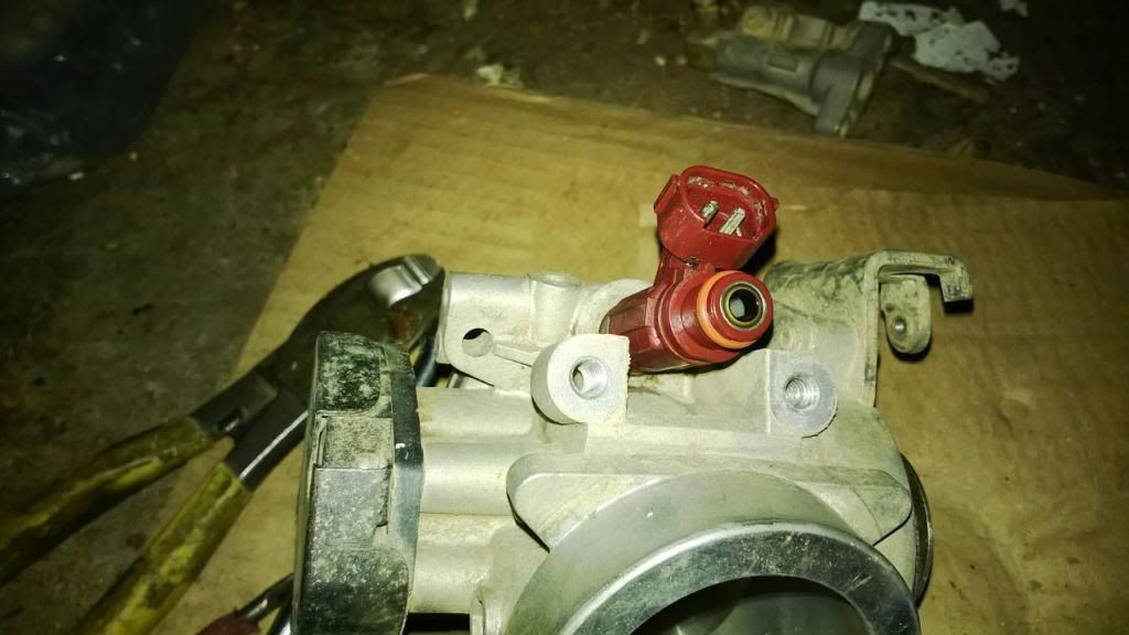

At last I think I have found the fault!
Using some heat, a no.3 Phillips bit in a socket spanner ratchet, and a LOT of force, I manages to crack off the threadlocked bolts on the fuel gallery.
I removed the injector, and found there is a very small filter in the inlet, which had a very small amount of brown sludge in it - just enought to block the gauze.
I used a very small screwdriver to carefully scrape away the sludge, then jiggled it in fuel to wash the remains out.
Clean again!
