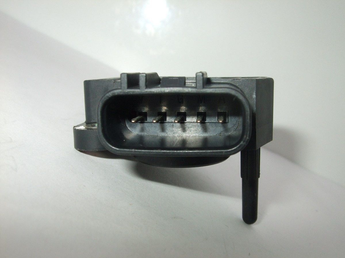

    So new TPS sensor, new wiring, no neutral blinking light but it runs. Runs oke when I give it some gas, on idle same thing (it idles a bit higher than before 1400rpm), stalls after a while. White smoke when I give it some gas -> water? Maybe head gasket? But then it should run no? PU plug is still good (2.16kOhms). Try with lambda and let computer do the maths to check if it gets better? Or adjust the CO value's again? I am a little bit stuck here, I hope some of you can shine their light on this case :D

    So update: I have 3 tps sensors, the original is failing sometimes on the manifold pressure sensor. Second one is broken, third one is a new one, but the voltage is inverted (goes from 4V throttle closed to 0V throttle open). So this is normal that when I rev it it stalls...

    So I got another TPS sensor...
    Plugged it in... Same problem as the previous one
    Has there been an update from the sensor that instead of going to 5V that it goes to 0V? (closed throttle to open throttle)
    I'm kinda sick of this stupid problem.
    If I plug the original sensor back in I get this:
    So I guess the proble is inside the sensor? If it was the wiring then this sensor also should be giving a wrong value, right? But it looks the same as the original one, check previous post for the link to the ebay page.

    To set the new Idle voltage? Yes I tried to do this, but because it gives the high percentage it reads around 4V, when I open the throttle, the voltage goes to 0V... So it always gives an error that the adjustments can't be set. Now I'm thinking that maybe the throttle body might be faulty? Ill take some pictures from when I'm trying to set the TPS.

    I might have good news for you Dynobob, less good news for me... The seller contacted their supplier of the sensors, and it's possible that there has been a faulty batch of sensors, but there is a possibility that they aren't going to order a new batch. So I got faulty sensors, a refund, and still a Husky that won't ride.
    Also contacted SWM, same issue, you have to order the whole body to get the sensor.
    Contacted Mikuni, they said to flip polarity (+ & ground), but I don't think that's a good idea. If they can garantee me that it won't harm the other sensors, fine by me, but I want it on email :) So I am waiting atm for an answer, probably going to try it anyways with an old sensor.
    I got 4 TPS, you want a picture from all?
    Conclusion, my first thought was right, faulty sensor, now to fix it!

    I'm not sure how you could flip + and ground. I don't believe there is a ground going to the sensor, only a 5v constant feed and 3 wires returning a percentage of that 5volts based on what the throttle, air temp, and barometric sensors are seeing.
  16. DYNOBOB Husqvarna
    Actually there are 5 pins, so maybe there is a 5v and ground. I still don't see how reversing them would help and it seems to me it would mess up the 5v feed to the other two parts of the TPS... ?
