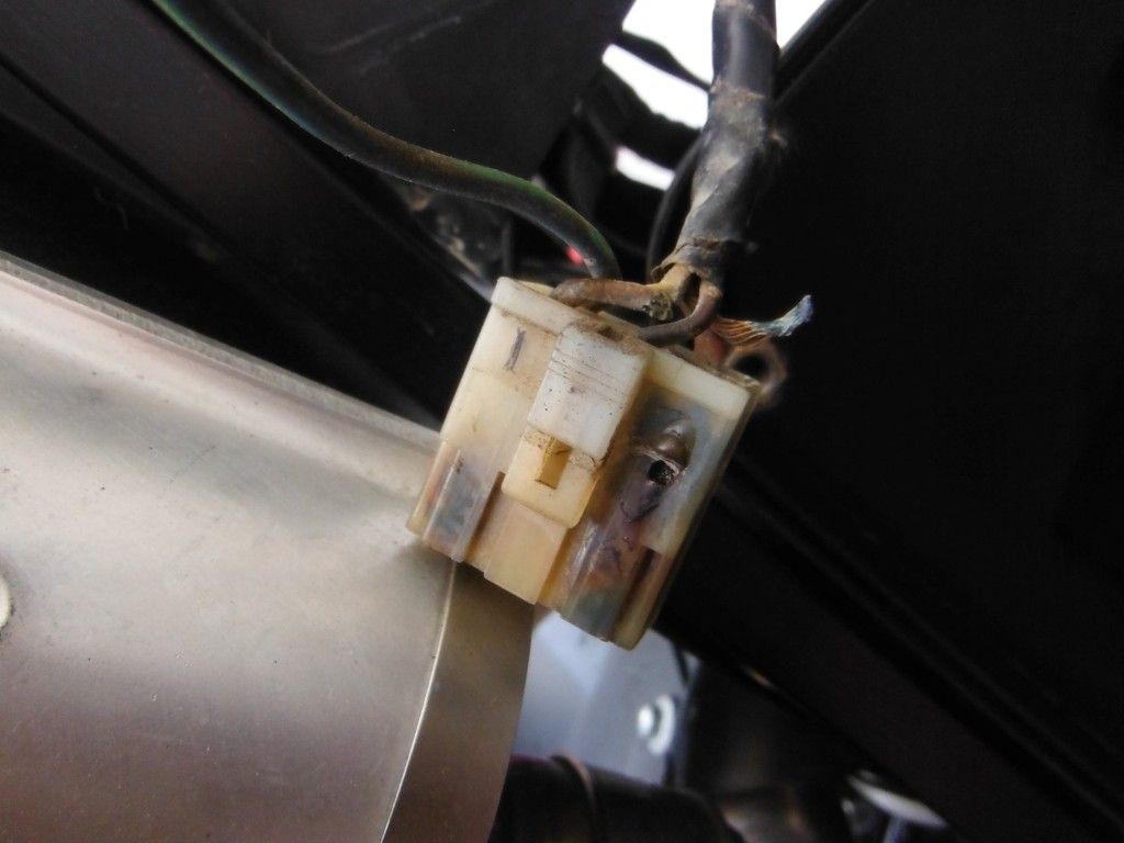

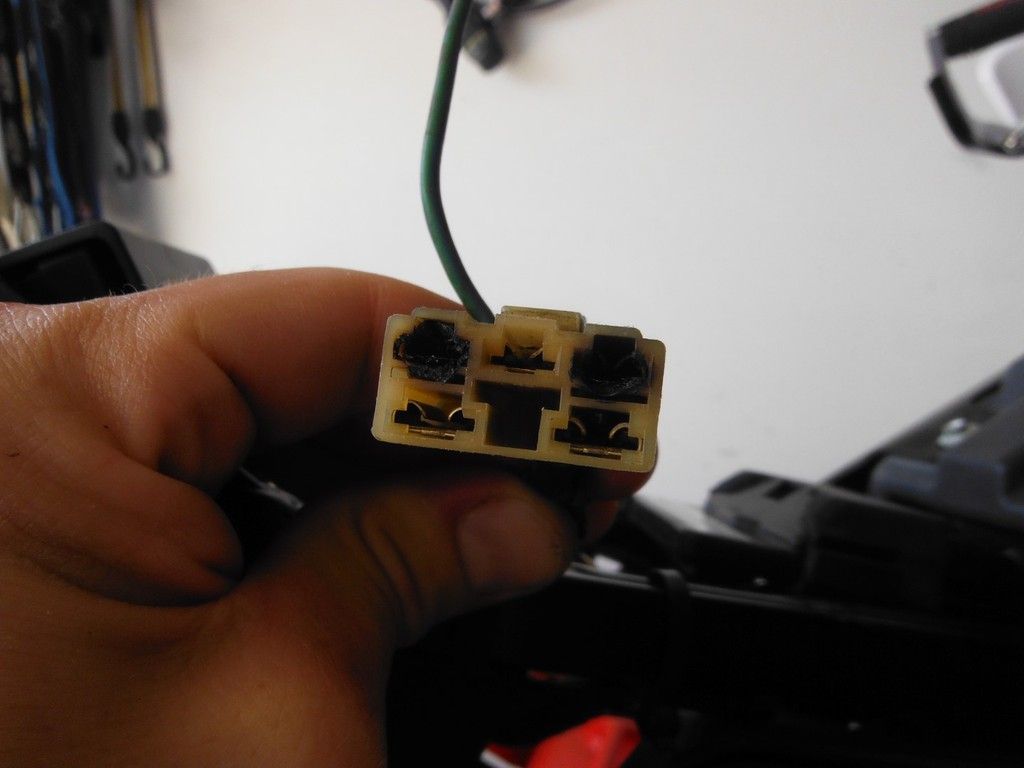

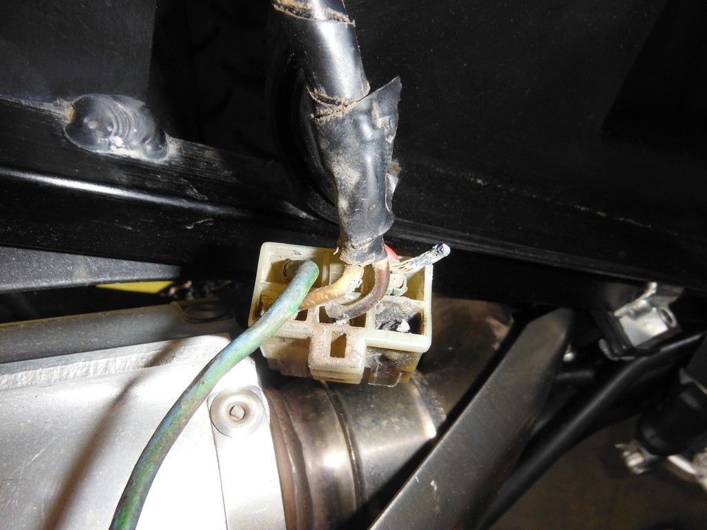

    Does anyone know a source for a replacement plug that would go into the voltage regulator? Bike is a 2011 SM630 but I think it would be the same for the TE630.
    After washing my bike it wouldn't start. It ran fine the day before when parked in the garage. During the course of my trouble shooting I found a corroded and broken wire going into the voltage regulator. Upon closer inspection I could see some heat damage.
    I am hoping this might be the reason for the no start but at the very least I have to repair it to move to finding another reason if it is not. Bike tries to start like normal but right where it would normally catch it sort of coughs and the starting cycle continues again, till I drain the battery.

    Just solder and heat shrink the wires together and do away with the plug.

    That will work great. Also any CBR600 or CBR900 one will fit from a bike wrecker. I predict that there are more than a few wrecked CBR600 around. Many, many other bikes use the same VR with the same plug. I would crimp on new terminals and go with the individual crimped terminals with no plug. I you are handy you can line the connector with saran wrap and pot the connectors together with glue gun or 5min epoxy. Not really needed here. Cam.

    I was able to spend some time on this today. Tested the voltage regulator with a multi-meter. All good. I snipped the plug off, exposed some wire and after crimping on new terminal ends plugged each wire to it's correct spot on the voltage regulator. Maybe I fixed it. Maybe the bike dried out from its bath during the time it took me to get at it. Don't care. Bike started up right away and ran like normal. I do have a new plug on the way and will upgrade the ground wire when it arrives. For anybody else who might need a replacement plug in the future try www.cycleterminal.com
