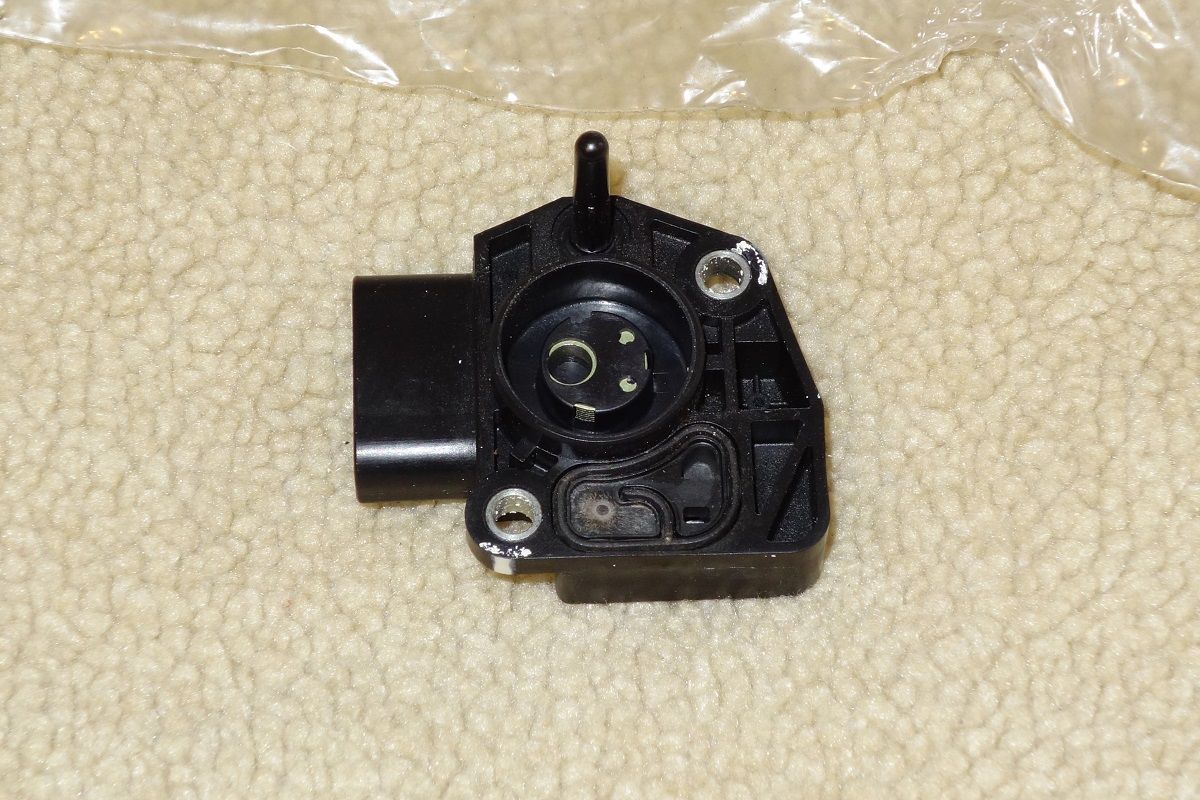

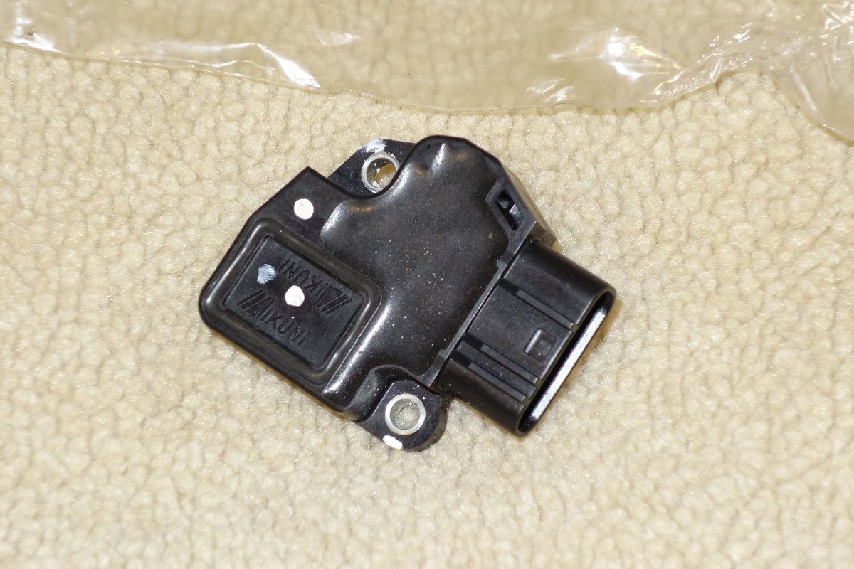

    It looks like the TPS from the Yamaha YZF125R is also the same part. I have one in my hand (see photos) and I'll try plugging it in and testing soon (got a busy few days ahead and a holiday starting on Wednesday, so it might not be for a week or so)
    From some Yamaha documentation, I believe it is also used on the YW125 Zuma scooter, but I've not actually seen the part to confirm it is identical. From my research, there is only one MAQS module that Mikuni make, so if an engine uses MAQS then it should be the same unit no matter the bike, spec or engine size, but it'll take a lot of digging to confirm this.
    Checking the parts fiche for Yamaha, it looks like the throttlebody and MAQS is a complete assembly there too.

    Got back from France last night, went over to the workshop today to so some work on the bike ahead of the Centennial Rally that I'm competing in, in a couple of weeks ( http://bigbikerallychallenge.co.uk/content/centennial-rally )
    While I was there, I swapped out the MAQS with the YZF125 item I got on eBay. It fitted fine, the bike fired up fine and iBeat reported no issues and all settings and measurements appear to be as they should be. It looks like it's certainly a viable candidate for replacement.

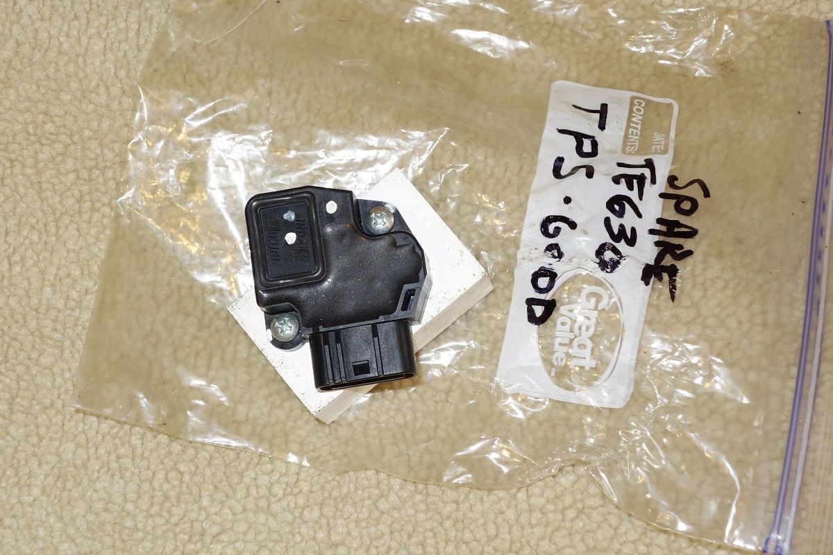

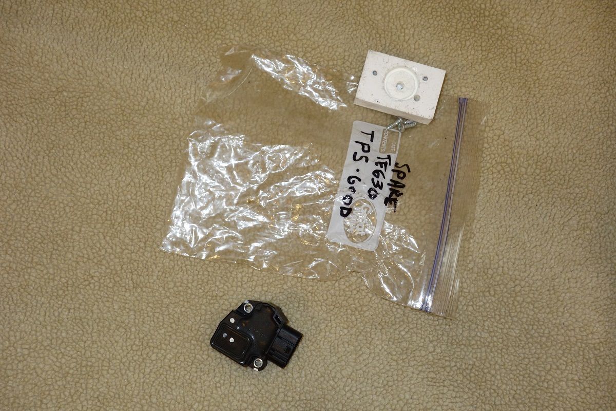

    I did eventually grab a 2008 Bandit 1250 TPS off Ebay for $40 to have a spare. Drilled some holes and mounted it to a block of pvc to keep the locator pin from getting broken.
