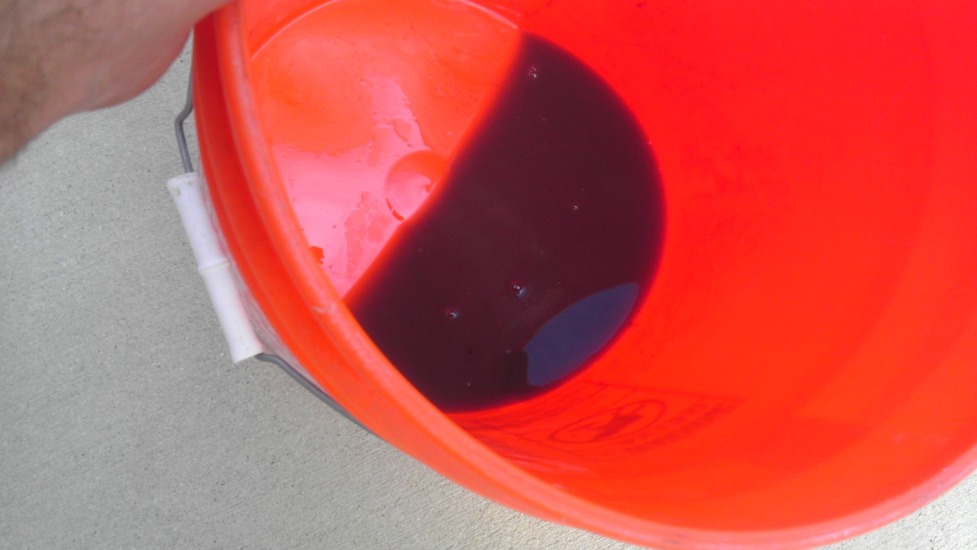

This is the stock coolant that came out of my 630.
I don't know what kind of coolant was in your bike, but if Evans was being used or a similar product, the coolant turns dark with use. It doesn't mean it has gone bad, it's just a change in appearance. Their coolant is more oil like, brake oil like. Evans states that their coolant is basically good for the life of the bike/vehicle unless water has gotten in to the system. Then it would need to be changed.
If darkening is not a result of the coolant used, their could be issues.
Not sure about the the 630 but on the 610 you need to remove a bolt on the jug to flush the system properly.
Mine came out around ~6k miles and was a translucent blue. I put the Honda green premix back in it, and it came out at 10k miles still looking like new.
If your coolant is transluscent and clean then you're good. I had not done anything with mine from new and I don't know if this is something the dealer adds on new-prep or if it's a factory fill. Y'all have your preferrences for coolant type, I went with G-05 coolant at 70% to 30% RODI water and it's pretty much clear liquid although a little higher viscosity than pure H20. Johngil was telling me you have to use a propylene glycol type for AMA sanctioned competition events. I would have preferred to order a gallon from Amsoil but didn't want to wait so I just picked up a premium antifreeze/coolant from the local autoparts house. I don't ride competition events so it's less of an issue for me.
My cap would accumulate brown/tan/gray gunk around fill cap seal, not sure what that is. Looks like a type of stop-leak to me. IMHO anything that is a type of solid in the coolant system cannot be good. All I'm saying is if there's any question then flush and fill with your preferred coolant. It holds just over a quart of coolant so it's a pretty minor deal but could be a big deal for engine longevity. Make sure your fan is operating by warming it up 'till it kicks on. The overflow bottle will accept coolant at temp, then draw it back into the radiator as it cools. Adding a couple of ounces to the bottle may help insure/speed this process. All of my bikes of late have had an overflow bottle, the old dirtbikes just vented to the ground. My KTM 250 would constantly lose coolant on slow going and then would indicate low in the filler. A mini overflow bottle fixed this. Normal fill level is just over the cooling plates.
My understaninding is the drain plug on the side of the motor allows draining without hose removal. The factory service manual indicates "either/or" for draining the system. I removed the right lower hose at the motor and put the garden hose in the radiator fill, ran 'till clear. Like I say, it looked like muddy water - not coolant. It did not look like oil, was not blue or green, was milky tan/light gray like dirt. I then removed the left lower at the radiator and sprayed water in it and it shot out the filler neck so I was sure it was a clean sweep of the system. Refilling took the factory specified amount (2.53 pts) so I was relatively sure there was only minor residual if anything in the cooling jacket. If you've ever looked at a disassembled cylinder you can certaily see there's not much coolant in there. If your waterpump stops or you lose your coolant they overheat instantly.
