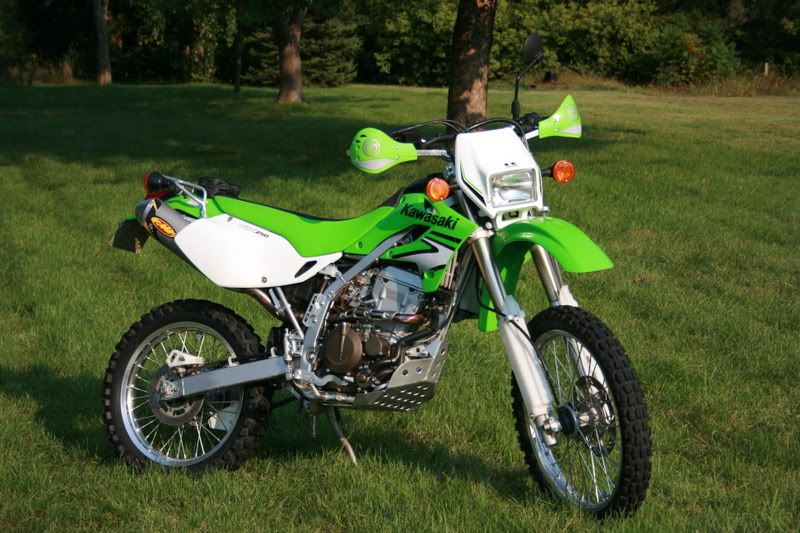

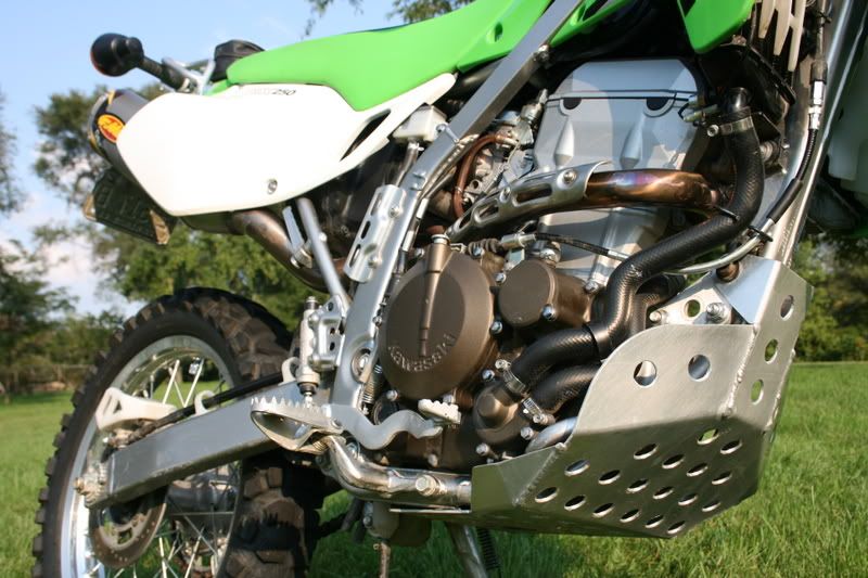

I made up a skidplate for my KLX250s using .125 aluminum plate and have had to straighten it a few times because of repeated abuse. :D That's why I am looking for something thicker.
KLX plate just finished.

That's what my homemade KLX skidplate in the pics above has ended up looking like.
