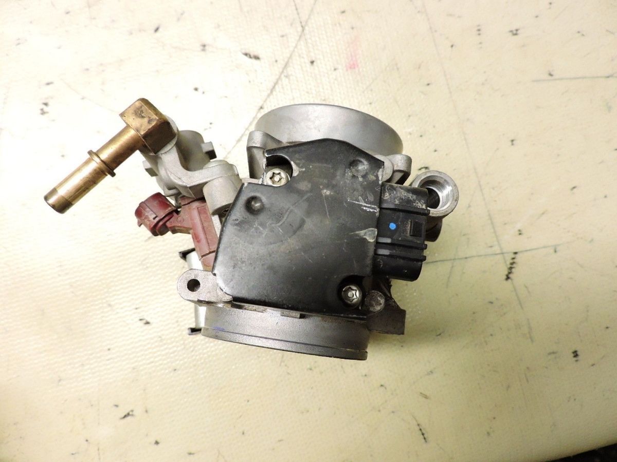

  4. DYNOBOB Husqvarna
    Best pic from that eBay ad.
  5. DYNOBOB Husqvarna
    A TE630 maqs. I believe it's the same under the protective cover.
