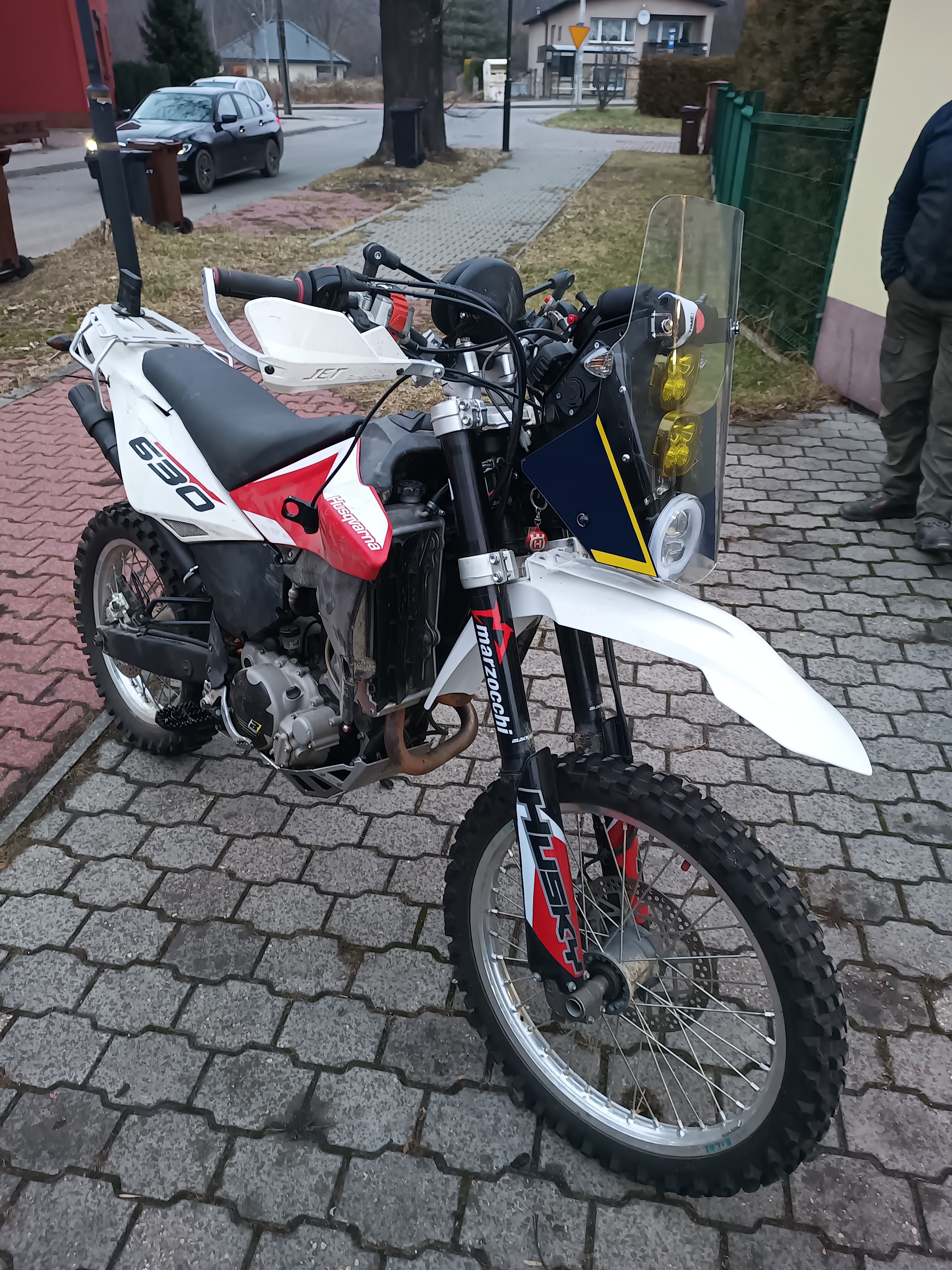

Ok, a little update on the build. As life verifies many thing its not going to ba "one of a kind" build. Rather same as everyone So far the bike got Rally Tower with very good lights and other accesories: 1 Main LED light is form Schwalbe l3e electric scooter, has EU homologation and very good coverage with low power consumption 2 Two auqillary lights are Baja Design knock offs form China with combo spread and yellow fog ocvers, REAL BUNNY BURNERS!!! 3 Double USB port, 12V socket, voltometer, blade fuse box with leds indicating when whey burn out, main tower switch and romate switch for auqillary lights on handelbar 4 Husky speedometer, vertical phone mount, towing strap, mootitool, CAT tourniquet and later 2 small first aid kits on sides, later spare leavers will be added 5 Bike got KTM EXC front fender for some sexy look, stock is terrbile... I also have fixed broken subframe even thoug it was already "strenghten" using hery thick gussets iThen i instaled very big and comfy footpegs from dakar driven Husky factory 449 from 2010. Bike is still going to run on stock fuel tank with extra 5L on luggage rack Now bike is much more usefull in terms of riding in low light conditions, wind protection and also much more organised in terms of navigation equipment. And finally some photos.... Windshield stickers will be replaced to match red/black/white color scheme and i will make some plastics to link windshield with plastics covering radiator
Tower is from this page https://adventure-bike.be/wp/winkel/701-rally-kit/husqvarna-701-adventure-rally-kit/ Plexi is off courde 100% transparent, and i have put bar risers, about 30mm. As for the navigation tower it has be modified a lot by me. Details in my post above.

As for the ohlins shock i dont even know from what bike it came. I just looked for a VERY long time until i've found one looking similar to stock one and it was bolt on fit . I just have a lot of luck. When i had Yamaha TTR i did the same with front USD forks and they fitted right on as well, even the bearings on frame head were the same. As for th front mud guars the one from pic above is from husky 125 SM version and it is rubbish, a lot of dirt were thrown in my face so i quckly changed it for KTM EXC style one except that i have found one with apadter. Like the one below. It is polisport one and works very well. Can be seen on later photos. POLISPORT KTM SX 2016 with adapter for SX/EXC 2007- 2013
