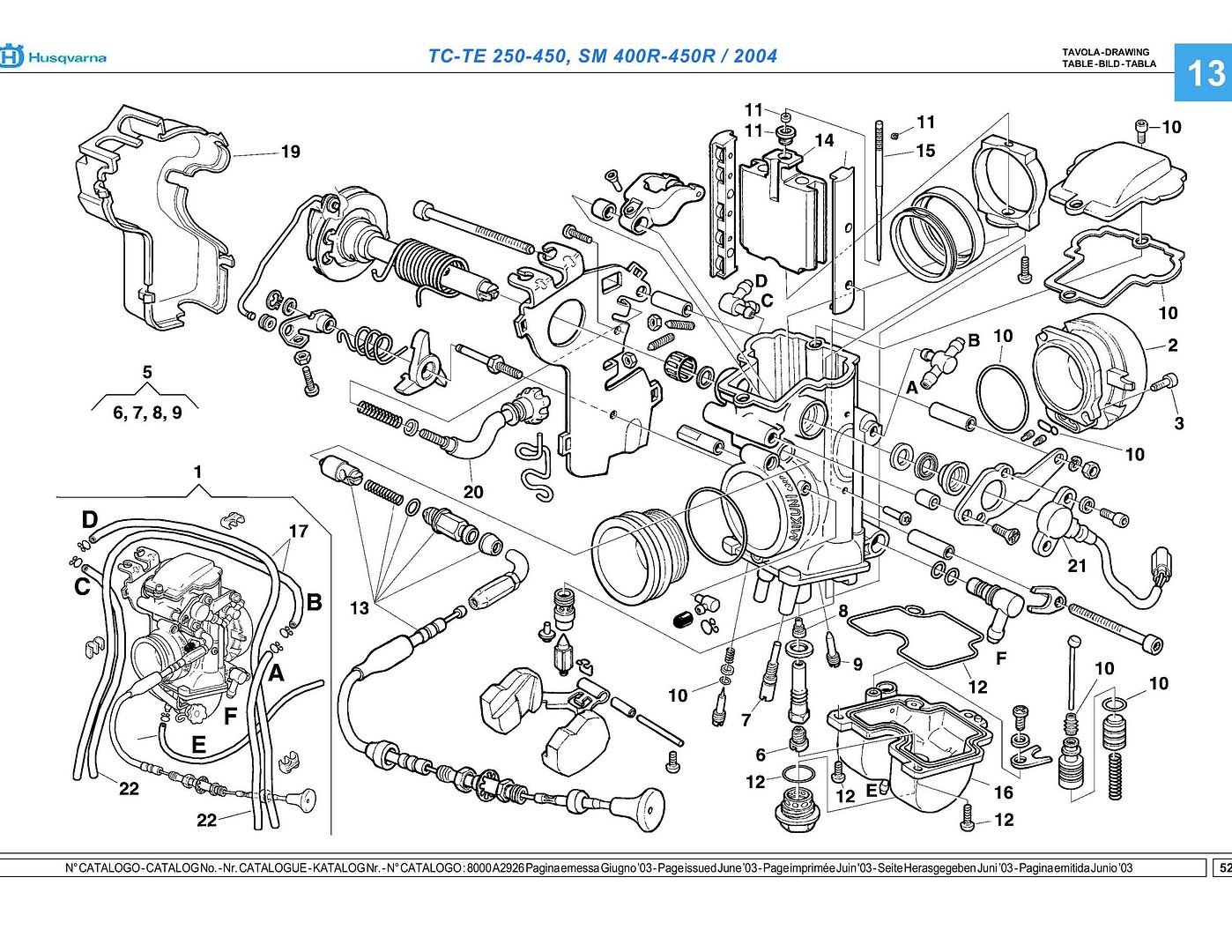

Hate to revive an old thread, but i'm having the same issue with my 450. I just wanted to confirm the part number that needs to be replaced. The part #37 mentioned above says needle jet on the fische I found on Sudco? Can someone point me in the right direction for part numbers? Thanks. :thumbsup:
Sorry for the ginormous picture...:excuseme:
Hello mate, the fuel metering float needle and seat are item #41 in the diagram you've posted and the o-ring for the seat is item#40.
Be aware that the carb on the '04 TC450 (which I'm assuming is the model you're looking for) is a Mikuni TMR 41, which is different to the one in the diagram.
Hope this helps.
Thanks alot. I searched on the Sudco website but could only find the "TM or TMX Series" carbs, the TMR I could not get a hold of. Your help is greatly appreciated! :thumbsup:

here we go, from the UK carb specialist Allen's website:
http://www.allensperformance.co.uk/exp-tmr.html
Part numbers:
40a: H2-786-36011-size Float Valve Assy (For Single Carb)
41: KV/10 O-ring: Float Valve Assy
The float needle / seat assembly is available in three sizes (2.0 / 3.3 / 3.8) so if you need one of these and your carb specialist can't help with identification you'll have to look for any markings stamped on the brass seat you already have. The numbers presumably refer to the size of the bore that flows the gas, so it's possible that the big TMR41 uses the largest (3.8) size (so the part number would be H2-786-36011-3.8) but I'm just guessing here...
I know that a lot of Jap multis use the TMR (here in the UK at least) so hopefully it can't be that hard to find the right part.

Call Halls Husqvarna and talk to Raymond. I just picked up a 50 needle from them. They are almost unobtainable. The TMR carbs are "special".
Thanks for all the info guys. Yeah it seems to be hard to even get a hold of the correct fiche let alone the actual parts...but I think I got it wired now. :cheers:
Or at least I thought I had it wired. Ordered the part #41 o-ring, but when I took apart my carb the o-rings were completely different. The rings on my carb have square outer edes and a little notch...the o-rings I got were regular o-rings with the rounded edges and no notch. :excuseme:
