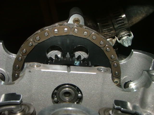

I finished reinstalling the head yesterday, and I have a couple more observations about assuring the cam timing is correct. It turns out you don't need to mark anything before pulling it all apart--all the marks are there for you already.
There are already some marks on the cam sprocket. The TWO marks on the gear portion of the cam sprocket align with the line on the head to indicate TDC.
Here is the tricky bit I figured out. When at TDC, the OTHER marks on the gear portion of the cam sprocket align with the marks on the cam gears!! The thing is, you can't SEE them aligning at TDC--your vision is obstructed by the head casting. Here's how to use those marks.

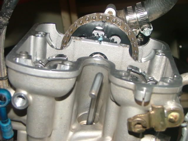

1. With the cams out, get the cam sprocket and timing chain reinstalled with the front chain slider and tensioner installed. You probably don't need the tensioner installed for this, but I wanted the maximum accuracy when verifying TDC. With the spark plug out, put something with a long, smooth, thin handle (like an hex wrench) into the spark plug hole so it is resting on the top of the piston. This is your TDC indicator.
Carefully move the engine through a few revolutions to verify the TWO marks align with the mark on the head when the hex wrench stops moving upwards. When you are satisfied that the cam sprocket and timing chain are properly installed, move on to step 2.
