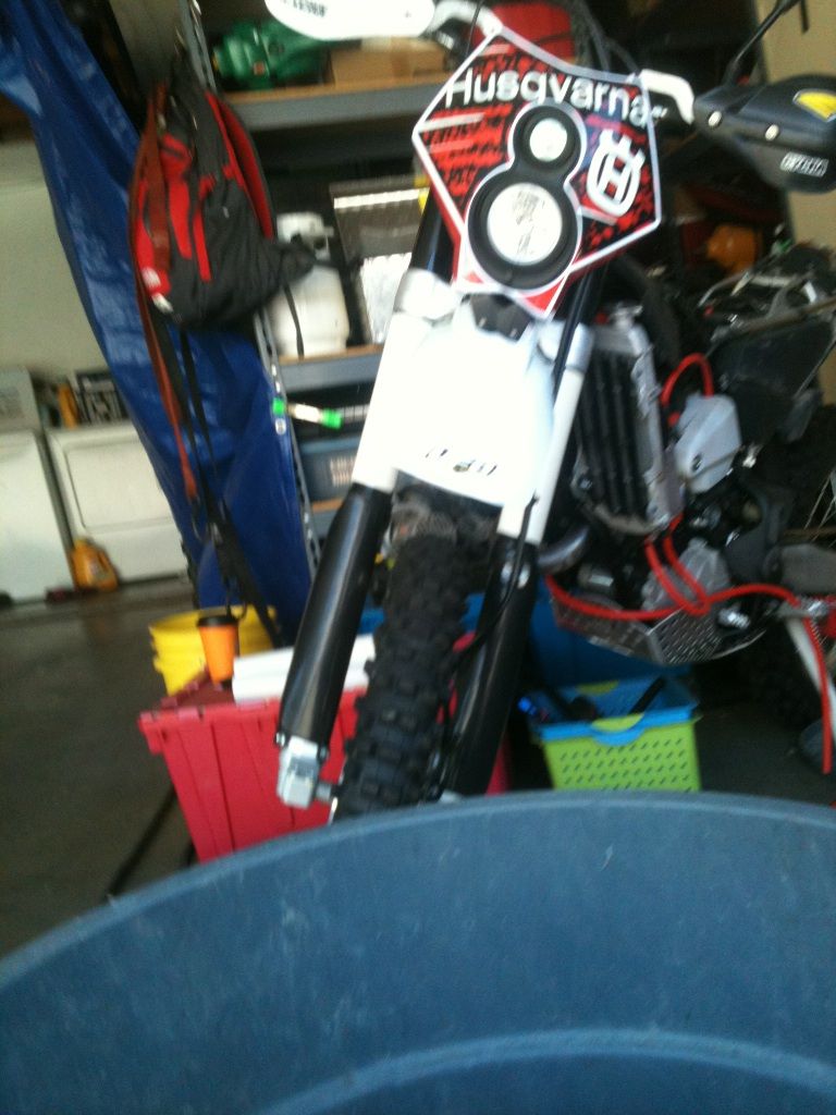

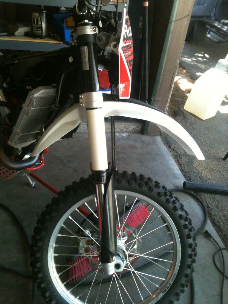

I don't know why it took me so long to make these guards for this bike. I have made them for all my other bikes and its been a stroke of luck that when my TE511 gets laid out on some rocks the upper forks have come out of it unscratched or damaged. My bike is still parked awaiting assembly but did manage to make the guards today. It's 2'' pvc pipe. Works great as a roost protector and will handle big rocks thrown at it. Many know of this trick mod for protecting your uppers and many don't. Cheap and works perfect:thumbsup: They just snap on and stay inplace perfectly:oldman:
