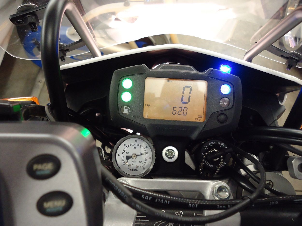

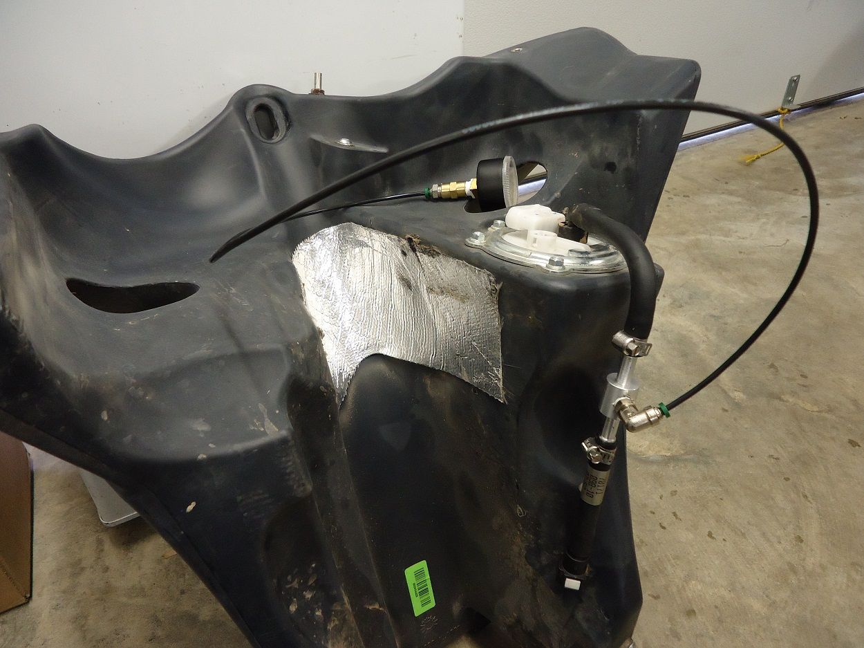

I think you have a fuel delivery problem (lack of fuel pressure). It could be you have a kink in the fuel line, failing fuel pressure regulator at the pump, or weak fuel pump. You need to devise a way to check your fuel pressure at the fuel rail/injector. I have a liquid filled gauge T'd into my fuel line and permanently installed on the bike by the gauge cluster.
Hey Dynobob, thanks for the tip. This is what the mechanics at the service think it should be but they did not take it apart yet. Should the fuel pump pressure be arround 45 psi?

I hope he actually tested the pump and didn't leap to the conclusion that the fuel pump is bad. It could be the pressure regulator has failed in the open position and is bypassing all the fuel back into the tank (another member here just had that happen). I've also seen the short fuel line inside the tank start leaking and loose pressure to the fuel rail (happened to my buddy twice but both hoses were aftermarket and ethanol fuel ate them). It's possible you have a bad pump especially if you ever ran the bike dry on fuel. Good luck! .
