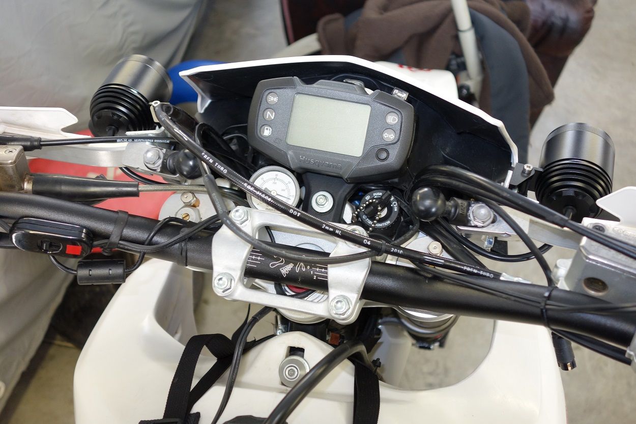

    '11 630SMS
    ADVMonster light pods are a great fit, I went with the 2000 lumen model and they are stupid bright. They have a 3600 lumen model but that's too much light for street use in my opinion, and you'll be blind when you go back to low beam. I tied the relay for them into the high beam circuit.
    THESE are the ones I have. I think they're using better lenses now, a rock cracked one of mine and I replaced it with lexan.

    Did you buy/have to buy the harness kit?
    Since I do not plan to install it myself, I know nothing about eletronics...and plan to take it to the dealership an have them install it, is it not necessary for me to buy the harness kit?
  4. RDTCU Husqvarna
    '11 630SMS
    You can, but the harness they sell is $40 for $10 worth of stuff.
    It may save you some hassle though. Just tell the dealer how you want it activated, like I said, i just have them come on with the high beam.
    You may want to splurge for the heavy duty mount, I would just use a button head screw with a wide head to mount it straight through the tank shroud.

  7. RDTCU Husqvarna
    '11 630SMS
    Nice, I like that, especially the high-low setting.
    I would probably signal relays with both the high and low factory circuits, and have a switch to disable them.
    As far as the quality on the ADVmonster lights, the only issue I've had was the one cracked lens, and I've had them for about 3 years of hard riding now, but I definitely prefer American-made when there's a choice.

    RDTCU, how did you mount the lights in there? Did you drill holes there?
    In the picture #1 of your set up, is it possible to mount the light to the bolt above it (in that picture), the one that holds the cover to the fuel tank?

  15. RDTCU Husqvarna
    '11 630SMS
    You would have to fab up a custom mount to make that work.
    I just drilled a hole through the tank shroud and used the supplied mounts with a fender bolt and locknut.
