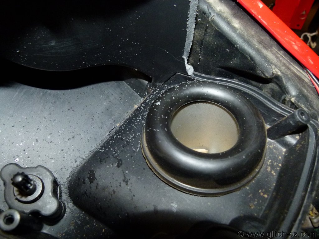

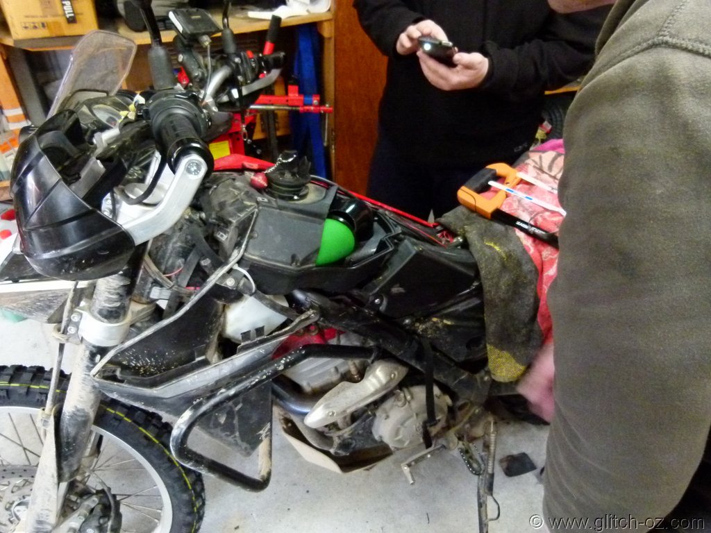

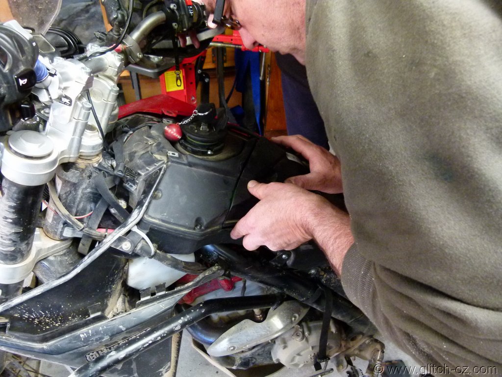

This is what my airbox looked like after the cutting but before the vaccuuming.

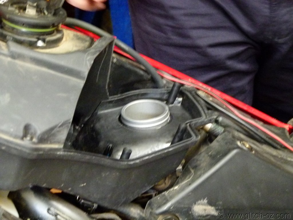

Pod in situ
Buttoned up

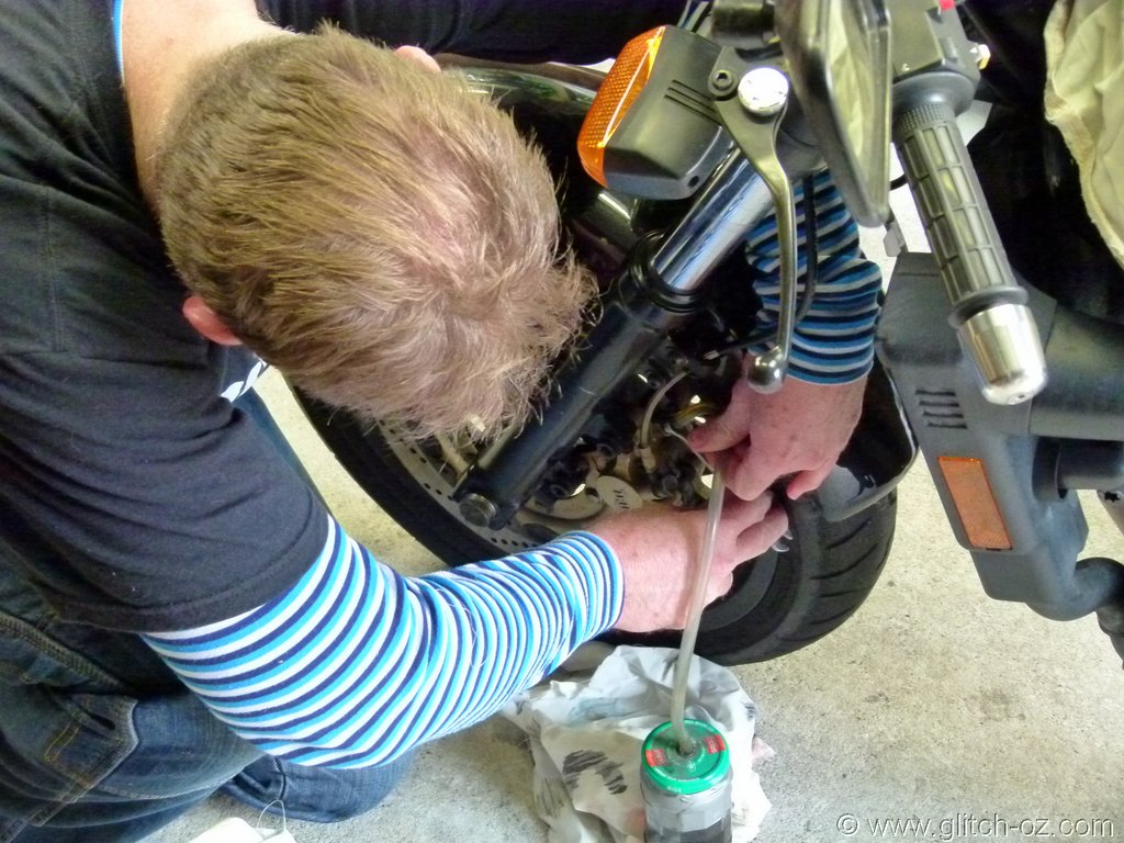

It all turned into a general day on the tools in the end.
A Trumpy getting the front anchors juiced up

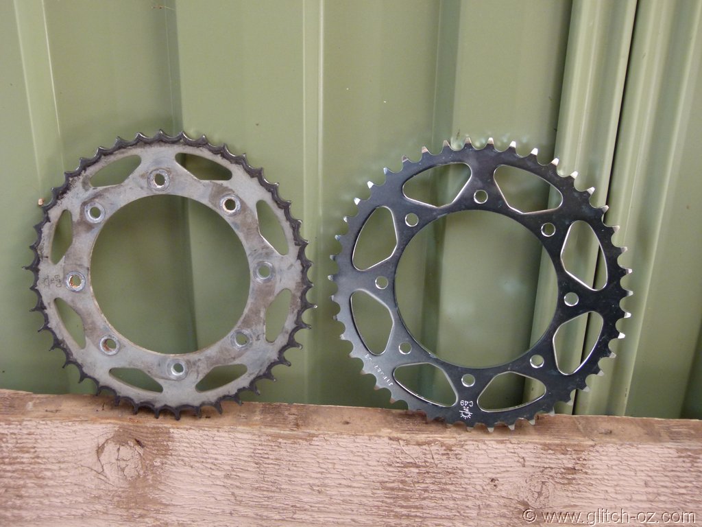

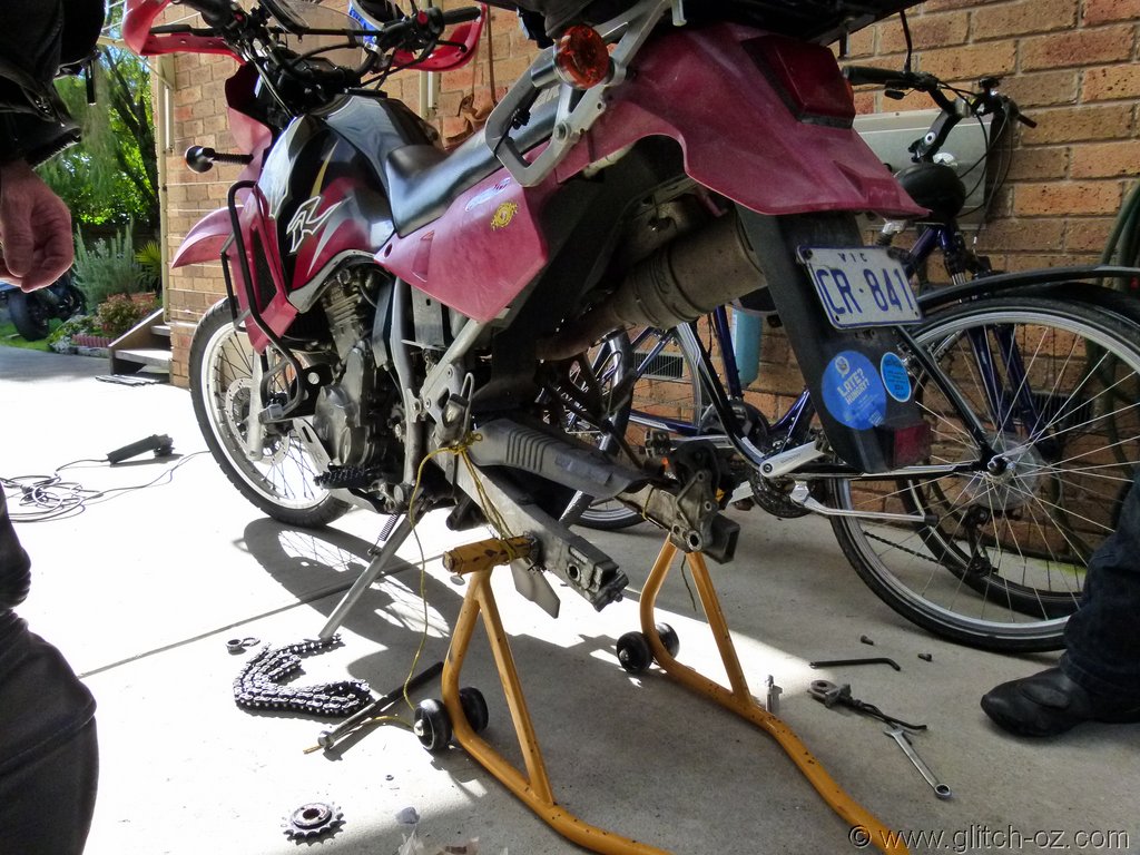

A KLR got some new cogs and a fresh chain
The odd TR getting surgery

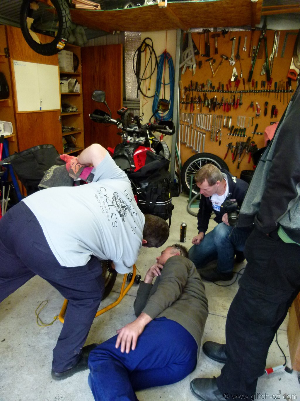

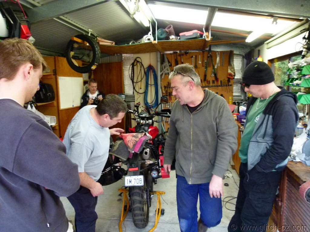

ozav8tr (somewhat blurred) in the rear left, "underneath" that dangling tire. Nev (light-coloured T-shirt) inspecting the rear of ozav8tr's Terra, self in those bright-blue panty/ pale-olive sweater.
Checking how big a hole we can drill into TR swingarms for the internal coating treatment (the green baby-poo schtuff)
Nev on the left... ozav8tr wielding the camera , kneeling on the right....self looking wondrously at a Terra's underbelly.

Due to a lack of TR's :eek::D, only 2 Terra's got done. Both had surprisingly clean airboxes, Nev's showed some signs of previous cleaning (by the shop) though....no accurate idea of how clean or dirty it might've been before.
Both instals went fine, the set of US-sourced parts turned out the easier and faster option, but in the end it all comes to the same result: Clean Air down the throat.
Learned how to tear the side-panel off the front clip, thanks to Nev for that.

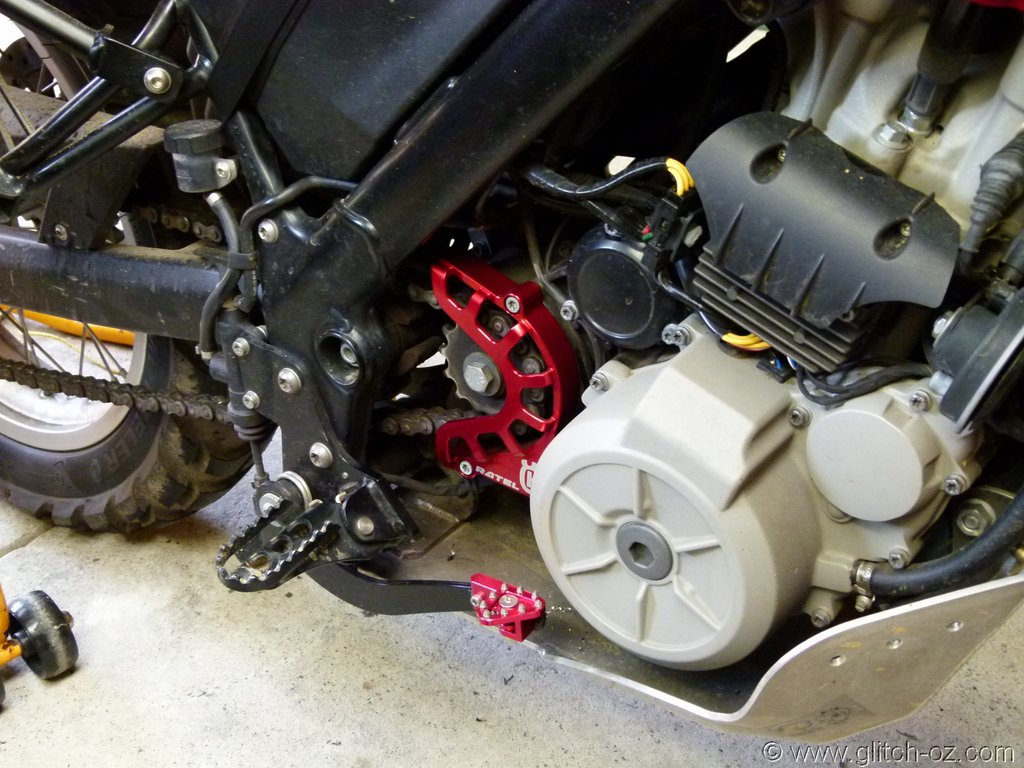

The red brake lever tip took a little metal-work to fit but was easy enough to hook onto the stock brake-lever.
