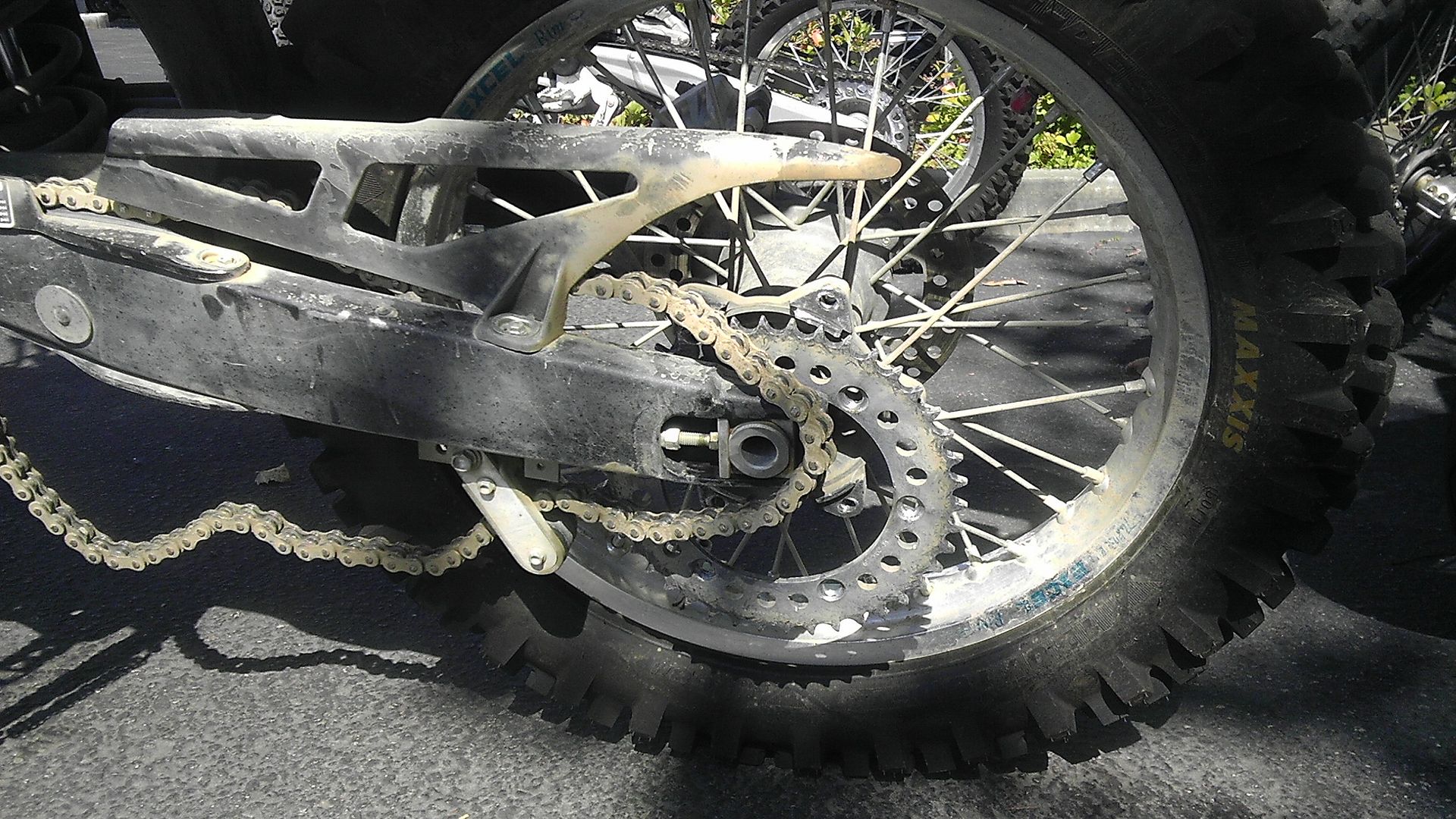

This doesn't look good. Bike was at Tri-County.
I had the recalled bolts installed and the still loosened up. Guess these did too.
I agree with Kenneth Webb. Stainless bolts, although pretty, are by no means and upgrade. They are very brittle and do not stretch as regular bolts do. Proper torque is determined by the amount the bolt stretches to provide the correct clamping force. Granted for most things they will be fine but personally I wouldn't trust them for footpegs, sprockets, rotors or anything where safety comes into question. Normal preventative maintenance and loctite should cure all loose bolt issues. Big singles are subject to very high vibrations and fastener torque needs to be checked regularly. There is no "fix" for that.
