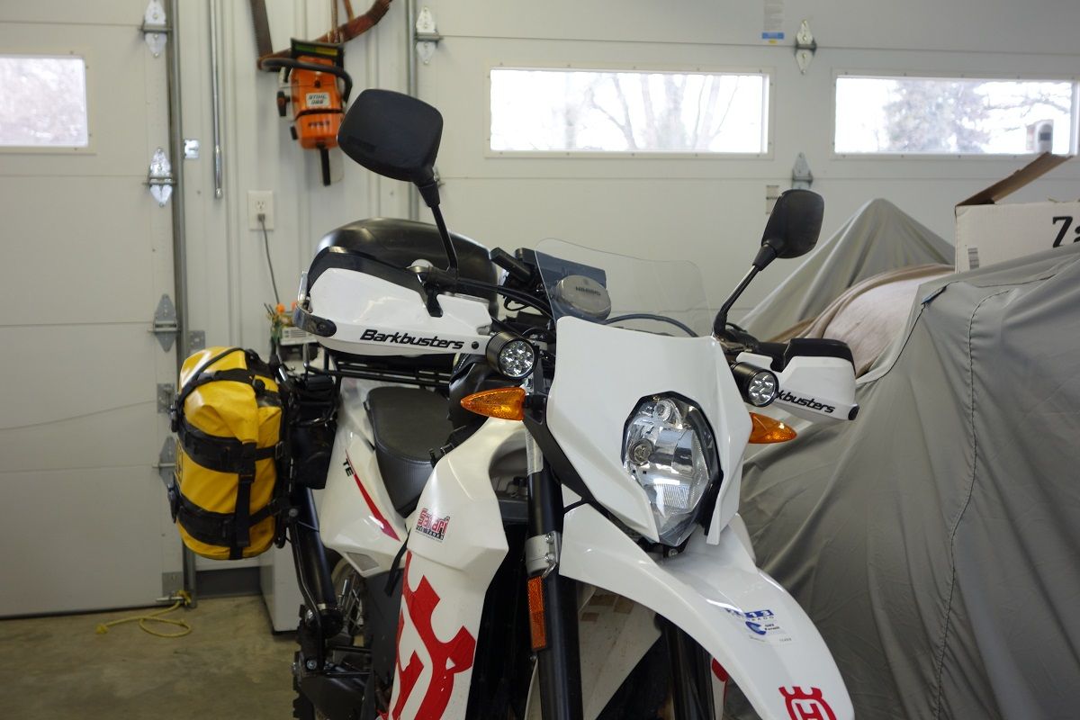

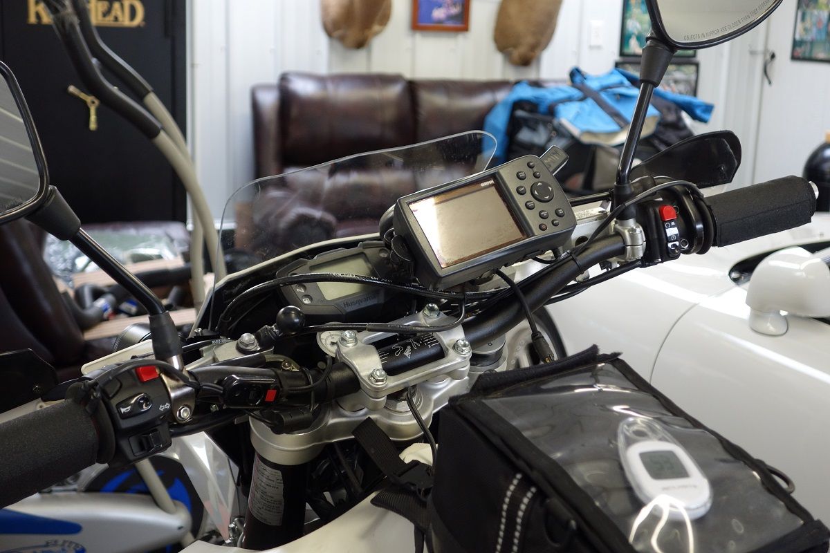

    The TCI plastic blocks a lot of wind. I did not leave it on the bike long because IMO it looked too big and I wasn't using the TE for hi speed road work. I don't recall any buffeting though (I'm 5'8"). I took their plastic off and made my own version about 4" shorter. It gave me buffeting so I cut it down even more, this gave me clean air hitting the helmet but still kept the wind pressure off my chest. I had to remove the windshield altogether when I got the Safari tank and I do miss it.

    I've been very happy w/ the height of my screen. I'm right around 5'10" as well. Bought the frame from TC and cut the Lexan myself.
    Plenty of calm air, but also doesn't interfere off road.

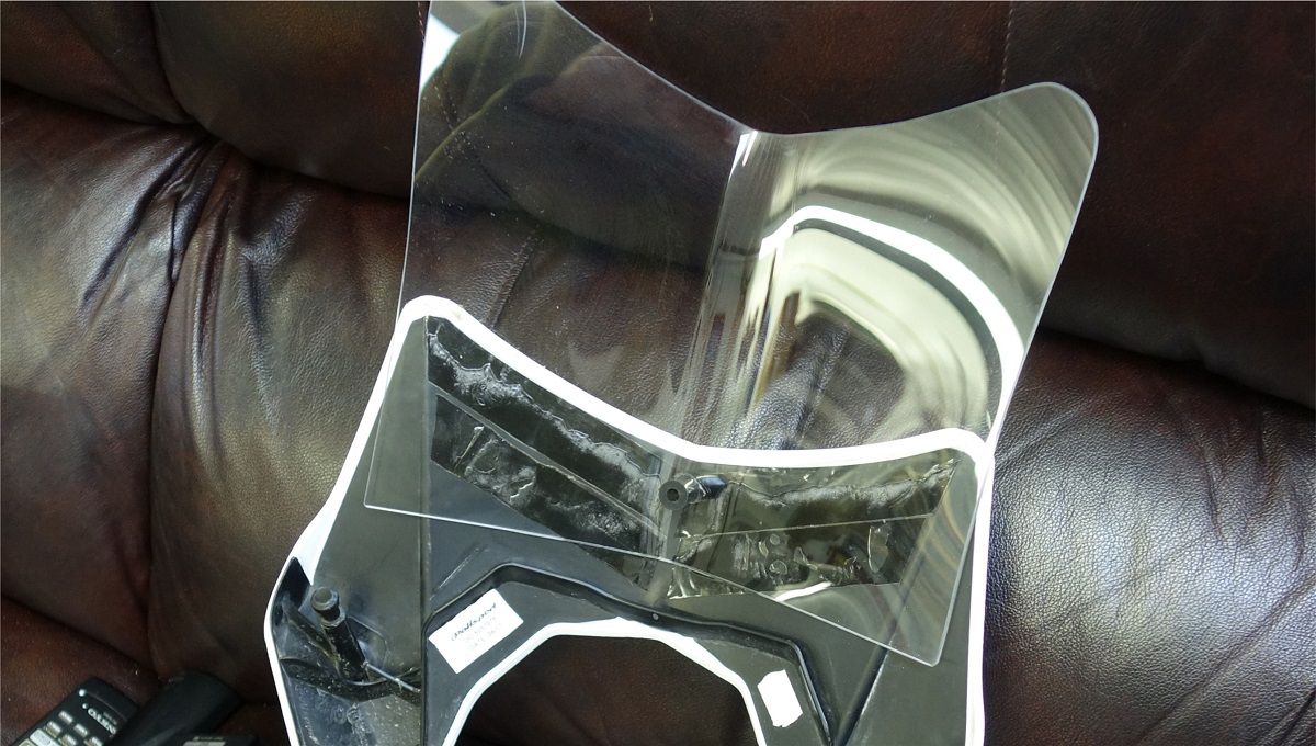

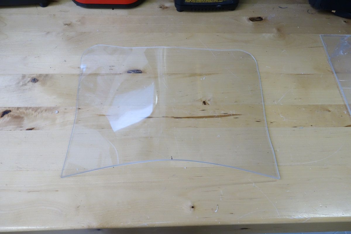

    My windshield evolution continues. I had to remove the TCI because the brackets hit the Safari tank and limit lock to lock (stock is bad enough). Considered the ktm 690 screens but thought I'd try this instead.

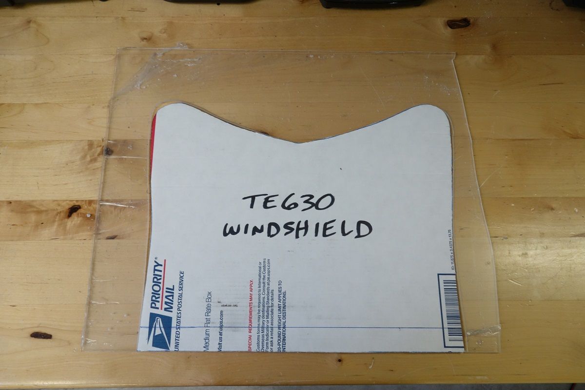

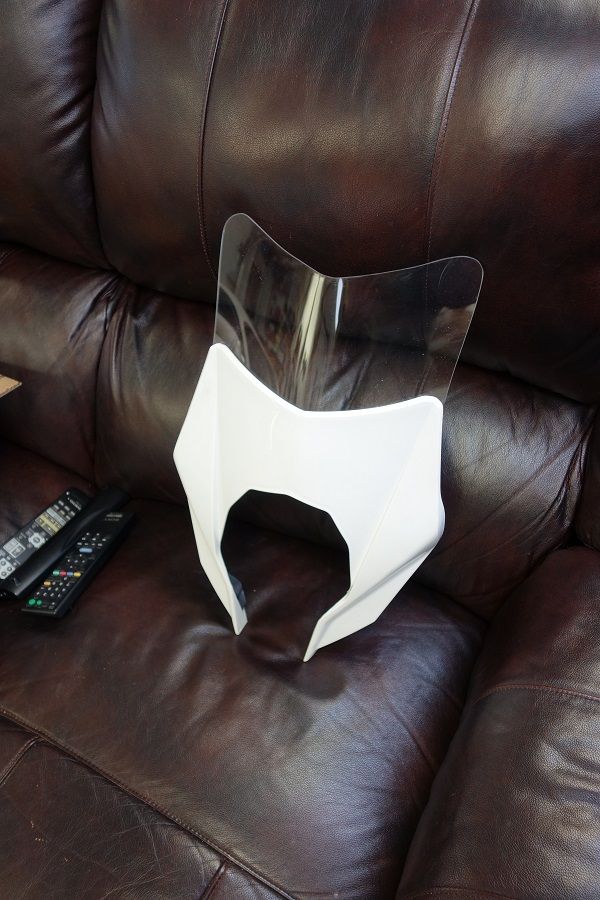

    I traced the top of the headlight shroud and played with cardboard until I was happy. Cut it out of lexan and heated it down the center w/ heatgun to bend it in a V that matches the shroud. Sanded the edges, put a good layer of 3M VHB on the back of the shroud and stuck it on.
    First prototype. I added 3/4 inch to the bottom to make the second one taller.
    Final result
    A couple details
    1. You have to leave a gap from the bottom of the lexan to the top of the headlight opening to clear the headlight bucket
    2. The plastic spacer (standoff) stuck to the lexan aligns with the plastic "bump" under/in front of the gauge cluster. This prevents any rearward movement of the windshield/headlight shroud. In fact, if you try to push the windshield backwards, it is rock-solid.
    3. If you didn't want it to be permanent, you could probably mount with velcro.
    Took it for a run last week and I'm happy with the results. It blocks the wind enough that cruising at 65-70 is comfortable.

  11. DYNOBOB Husqvarna
    Just your torso, helmet is still in full air flow (much like riding a sport bike). I'm a smaller person (140lbs), so you might want to experiment with a different (larger?) shape. Dirt cheap to experiment and you haven't drilled holes in anything.
    My goal was reduce the wind pressure on my chest and make something that could pass for stock by following the lines of the shroud.
