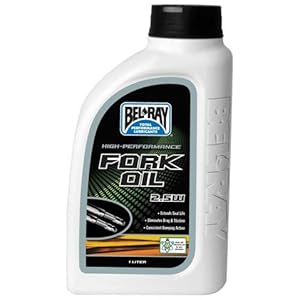

    I have the Kayabas and I had to go to a 2.5w BelRay fluid to get the forks more plush, faster on the rebound, more responsive in the rough stuff. I still have all the clickers set to full off/soft. The forks now match the rear end for rebound speed/rate.

    @OlderHuskyRider, thanks for the recommendation of the lighter oil. Did you maintain the same level as well as using the lighter oil? Also, what about the fork cap wrench? I am confused and am not sure what to get. Since I will have to order something off the web, I want to get the right one and although I keep searching on 48 MM Kayaba fork cap wrench, I get many hits for many different size wrenches - none are 48, but seem to all be 47 or 49 MM. Obviously, the wrench size is not the same as the size of the forks themselves, but I don't know which to choose and don't want to go through the purchase, try, return until I get the right size thing.

    I maintained my OEM level, no more, no less, my forks travel the entire 11.9 inches and I have no leaks.

    I used 325ml of oil in the outter (the range is 325-360) I went with Maxima racing fork flucid 5wt. But that gave me factory like feel, which is what I was looking for) so maybe 2.5 wt would get you softer. Set the oil level 325ml and go up 5-10ml at a time if you need to. I use a turky marinnade injector in the air bleed holes to add oil.
